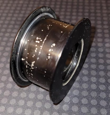

    I swapped out my roached lower pulley yesterday.
    Check out the anno flaking off and the wear line on the front edge. I know my pullies are centered because I bought the tool to measure it but the belt still tends to ride on front edge of this one. I measured 1.5mm difference in the offset from flipping this on it's post. They used Koyo bearings surprisingly but with metal shields that aren't any good at keeping moisture out.
