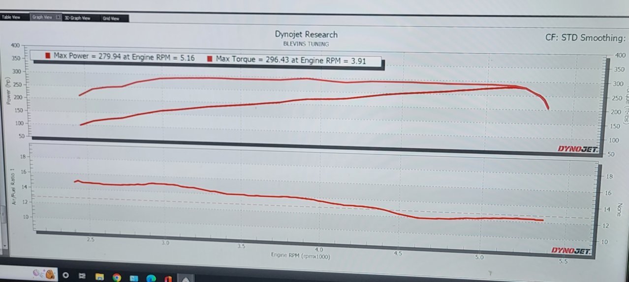

    Heres my run from today, on a dynojet

    Looks good, but looks like you could use a little more fuel on the top end. 11.5:1 AFR would be my target. Anything over 12:1 would worry me under high load

    Any idea what psi boost the kit is running?

    Yea its set to 8psi, it can get up to 10 just revving it, but it seems to peak at around 6psi in 1st
