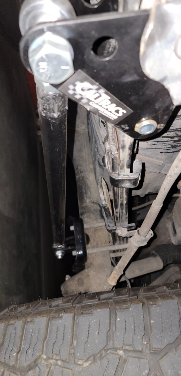

  14. Aug 28, 2022 at 6:43 PM
    #674
    Smokehouse
    Smokehouse Procharged
    May 7, 2017
    #218444
    511
    Zach
    Republic, Missouri
    2007 Super White Tacoma Sport
    Cal tracs installed at the recommendation of torspd and I couldn't be happier, hooks super well now.Snapchat-836869594.jpg
  15. Aug 29, 2022 at 7:50 AM
    #675
    Torspd
    Torspd Tor-nication
    Sep 18, 2009
    #22958
    26,473
    Tor
    The Great America!
    MMVI 4.4L 4x4 Access Cab
    Torspd Custom Turbo kit [] Borg Warner 9180EFR Turbo [] Haltech Elite 2500 [] TiAL Q BOV [] TiAL V44 Wastegate @ 15psi [] CP Pistons [] CP Carrillo Rods [] ARP Head studs [] ARP Main Studs [] ARP Header - Head Studs [] Ported Heads w/ 1mm oversized valves intake/exhaust [] Brian Crower Forged Stroker Crank [] Darton M.I.D. Sleeved Block [] Kelford Camshafts [] Torspd 160* T-stat mod [] APR Large Fuel Rail [] Walbro 460 LPH E85 Fuel Pump [] FueLab FPR [] APR T56 Conversion Kit [] KP RACING Built T56 [] McLeod Racing Custom Twin Disk Clutch [] One Piece Aluminum Driveshaft [] MGW Shifter [] Custom lowering kit [] Ohlins Front Coilovers [] QA1rear shocks [] Custom Ron Davis Radiator [] Dual SPAL Electric Fans []
    No more wheel hop FTW! Glad you're pleased. And still has a good bit of articulation. Can't say how much because my truck is lowered.
    Smokehouse[QUOTED] likes this.
  16. Aug 29, 2022 at 8:35 AM
    #676
    SUMOTNK
    SUMOTNK Pavement Pounder / Mall Crawler
    Sep 8, 2014
    #137895
    3,076
    Eddie
    NorCal/South Bay Area
    Looks like a Gen2.5 TRD Sport, but really an '08 TRD OffRoad
    TRD Supercharged / OTT Tuned
    Comparing the design of the Caltrac to the other two products (urd, budbuilt) that serve the same purpose...... i think its a no brainer to go with Caltracs. I would give up that ground clearance versus having to repair the rear pumpkin.
    Smokehouse likes this.
  17. Aug 29, 2022 at 8:51 AM
    #677
    PhoS
    PhoS Proffauxssional
    Apr 8, 2020
    #324146
    1,324
    PNW
    08 FJ Cruiser
    Contains MSG
    The URD should have a smoother feeling since they utilize a couple bushings vs. the heims on the caltracs. I have a heim only 3-link in the FJ and you definitely can feel it.
    SUMOTNK[QUOTED] and Smokehouse like this.

  20. Aug 29, 2022 at 12:50 PM
    #680
    Lucario Runner
    Lucario Runner Resident Truck/SUV racer
    Jun 29, 2011
    #59067
    7,205
    Robert
    San Antonio, TX or nearest race track
    06 Toyota 4Runner
    AFE stage II intake, APR X1, URD 70mm Throttle Valve (ported and knife edged), NST intake manifold spacer, URD spec U headers, Denso IKH20, URD fuel pump, APR fuel rail, URD Y pipe, URD spec u catback, lightweight water pump pulley, Greddy sandwich cooler plate, Earls oil cooler, IPT valve body, FJ TRD shocks, Cusco front and rear sway bars, Energy Suspension rear track rod bushings and rear link bushings, Carbotech pads, Stoptech ss brake lines, Stoptech slotted rotors, Motul 600 rbf, Limited Grill, Painted hatch cover by me, Painted valve covers by me, Cobra CB, TRD rad and oil cap, Escort 8500, Autometer oil psi and temp gauges, AEM wideband afr gauge, Flexpod, Pioneer 400w speakers.
    Couldn't be the pre tsb leafs and the 35's? I can report no wrap on my truck.
