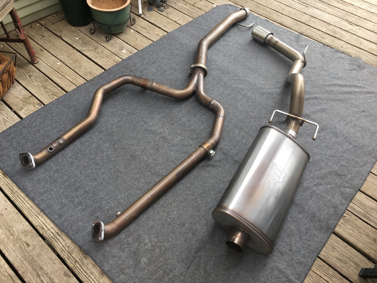

    the old
    the old spec u exhaust kit they used to sell right? Any idea how this compares performance and sound wise to the roostfactor design

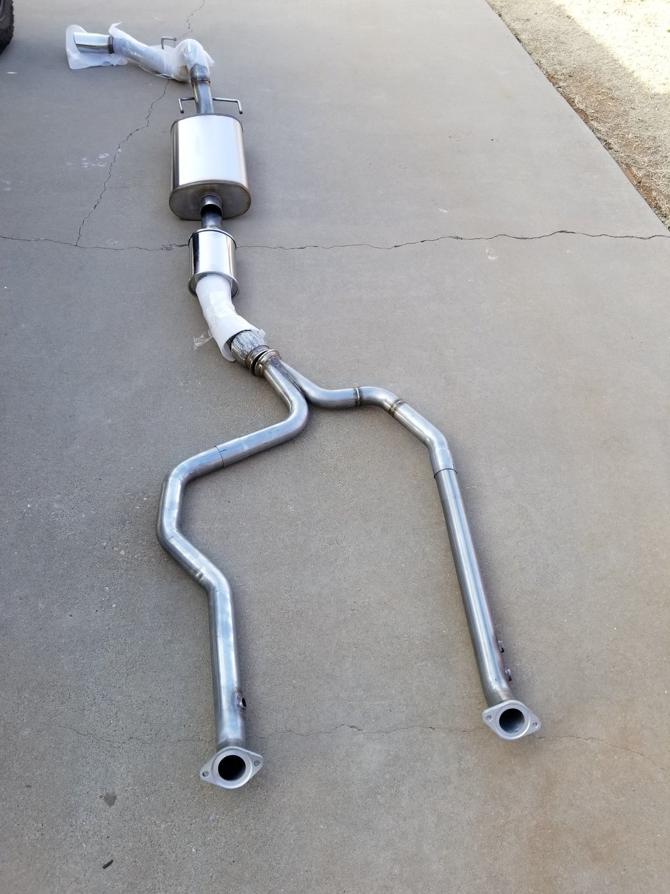

    This is the one for the third gen actually
    Here is the 2nd gen

    I was talking just the Y pipe. Nothing really fancy about the rest of it.

    This is the 2nd Gen kit. I have the newer 3rd gen kit (edit - I should clarify.. When I say 2nd Gen or 3rd Gen kit I'm referring to the generation of the exhaust design, not the Tacoma Generation) which uses a much larger 2in/1out resonator that contains the merge collector for the secondaries. The rest of the kit is the same functionally. I don't have pics (its in storage) unfortunately.
    I'm planning to use it for my "1GR-FE N/A Dyno Testing" series I'm going on this thread: https://www.tacomaworld.com/threads/1gr-fe-single-vvti-dyno-testing-by-ott.759616/
    I've used the Gen 2 system (the one pictured in my quote) previously.
    I've run the following setups:
    Stock Exhaust Manifolds - SpecU (Gen 2) exhaust
    SpecU EL LT Headers - SpecU exhaust
    SpecU EL LT Headers - Stock Ypipe - Stock Exhaust
    SpecU EL LT Headers - JFR EL Y w/ 3" Exhaust/Keg Muffler
    My favorite N/A setup was the Headers w/ stock y and exhaust.
    I don't think there's a major difference between the JFR and SpecU setup exhaust wise. I think the JFR had a little more low end torque but that was all just seat of the pants feel.

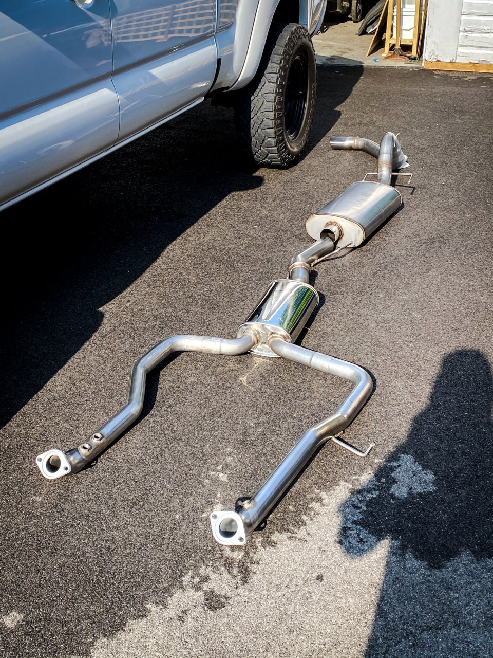

    Here's a pic of the 2nd Gen "Gen 3" Spec-U exhaust.
