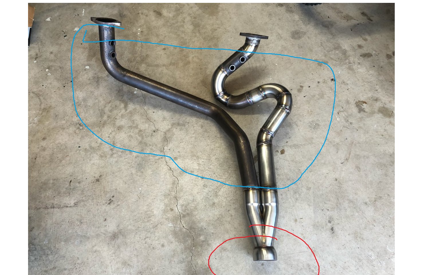

    I'd love to hear this setup

    I do not. I sold it shortly after I came into possession of it.
    I can probably answer or at least guess at what you're going to ask. :)
    The secondaries are about 44" to the beginning of the merge collector. 52", give or take to the 3" flange of the merge, depending on how long your merge collector is.

    When you say secondaries what are you referring too?
    Also 52" is from the beginning of the Y Pipe to the flange of the merge?

    What you've functionally circled in blue are the secondaries.
    Figure about 52" from the exhaust manifold flange to the end of the merge collector (roughly the center of your red circle), where you'd flange/v-band it and continue to your exhaust section(s).

    That is incredibly helpful. I don't suppose you know what grade stainless he used or if you have a recommendation. Everything i find online suggests 304 but my fabricator seems to think 316 is the way to go but neither of us have any exhaust experience so

    304 would be more than sufficient for the ypipe/exhaust. The 316 will be more corrosion-resistant, but I bet you'll get it caked in mud soon enough. ;) I wouldn't have a problem with 304 if I was having one made for what little that may be worth. But if your fabricator has 316 on hand to do the job make him happy and you'll be happy :)
    Hell, most Tacoma exhausts are 409
