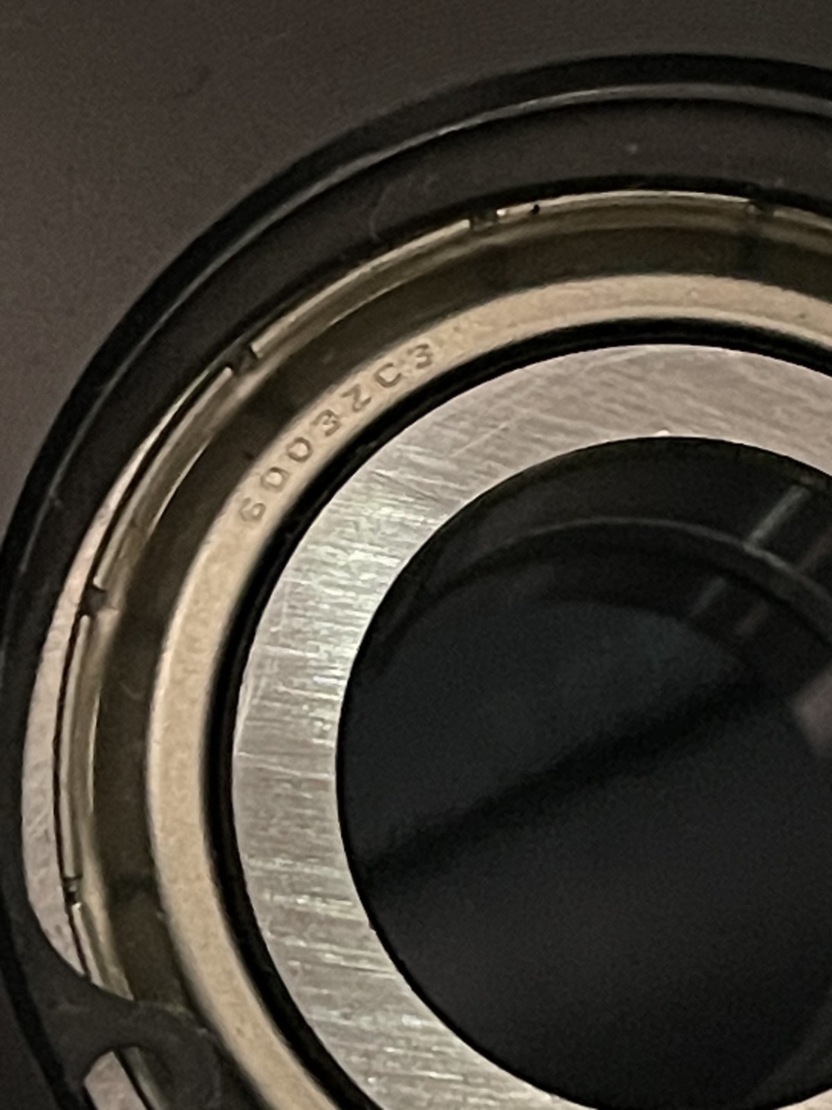

    My new pulley came in. looks like they’re Koyo bearings stamped with 6003zc3

    Yep, those still have metal shields on both sides so same thing as a ZZ or 2Z. Just don't put an RS bearing in the small pulleys like what the bigger pulleys have. (RS= Rubber shield) They spin way too fast and will destroy themselves.

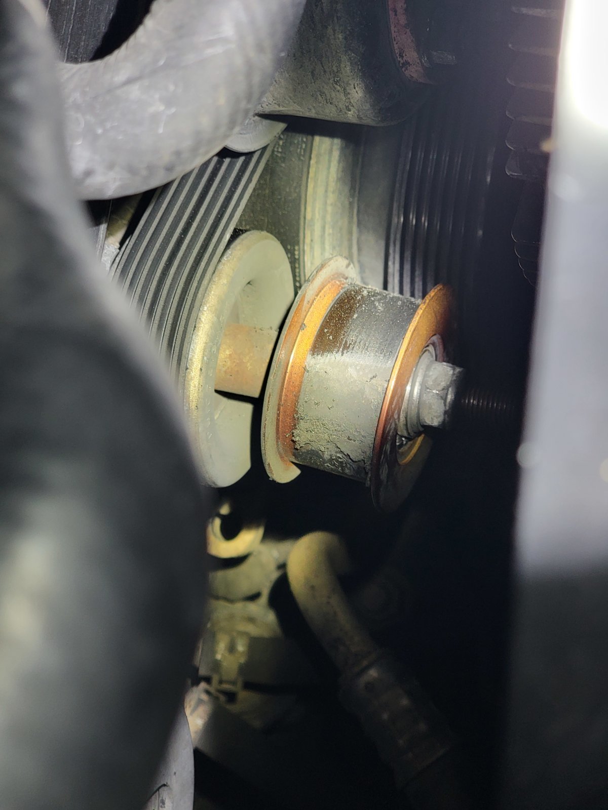

    Good info. Thanks. Would you happen to know torque specs for the tensioner pulley?

    Not sure if yours is the same as mine. My lower pulley has 17mm lock nut, no torque spec given. I just tighten it down by hand with a box wrench.

    Yea mines different then. Doesn’t have a that. Just bolts on. I’ll inquire through them and share what they say.

    Called them this morning, they said 40f/lbs with some red locktite

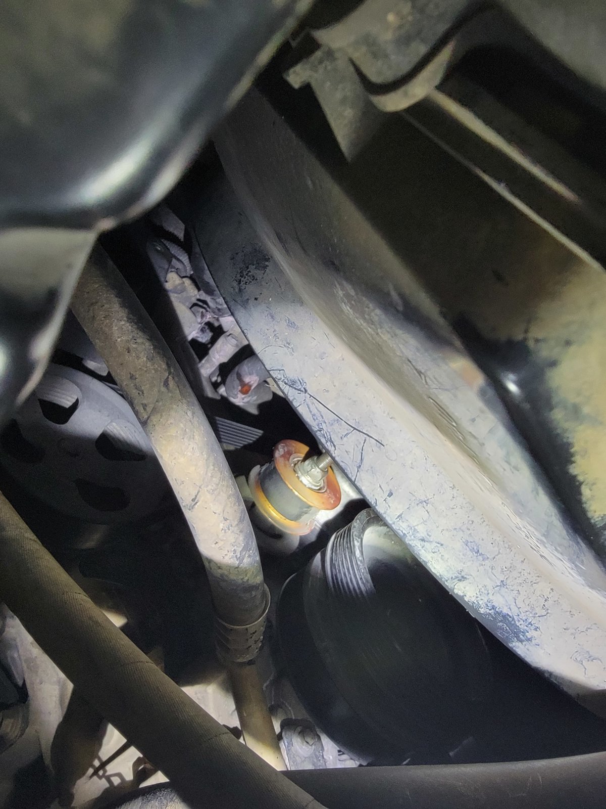

    I was at a concert about two hours away from home and started smelling burnt rubber and truck suddenly got much quieter lol. Ended up throwing the belt on the Procharger so trying to get that belt out of my radiator fan on the side of the road was fun. Pulley is absolutely toast20240421_204958.jpg 20240421_204856.jpg Screenshot 2024-04-22 090534.png

  10. Apr 22, 2024 at 8:39 AM
    #810
    Torspd
    Torspd Tor-nication
    Sep 18, 2009
    #22958
    26,473
    Tor
    The Great America!
    MMVI 4.4L 4x4 Access Cab
    Torspd Custom Turbo kit [] Borg Warner 9180EFR Turbo [] Haltech Elite 2500 [] TiAL Q BOV [] TiAL V44 Wastegate @ 15psi [] CP Pistons [] CP Carrillo Rods [] ARP Head studs [] ARP Main Studs [] ARP Header - Head Studs [] Ported Heads w/ 1mm oversized valves intake/exhaust [] Brian Crower Forged Stroker Crank [] Darton M.I.D. Sleeved Block [] Kelford Camshafts [] Torspd 160* T-stat mod [] APR Large Fuel Rail [] Walbro 460 LPH E85 Fuel Pump [] FueLab FPR [] APR T56 Conversion Kit [] KP RACING Built T56 [] McLeod Racing Custom Twin Disk Clutch [] One Piece Aluminum Driveshaft [] MGW Shifter [] Custom lowering kit [] Ohlins Front Coilovers [] QA1rear shocks [] Custom Ron Davis Radiator [] Dual SPAL Electric Fans []
    Burnt toast. No butter.
    TacoLeeSD and Smokehouse like this.

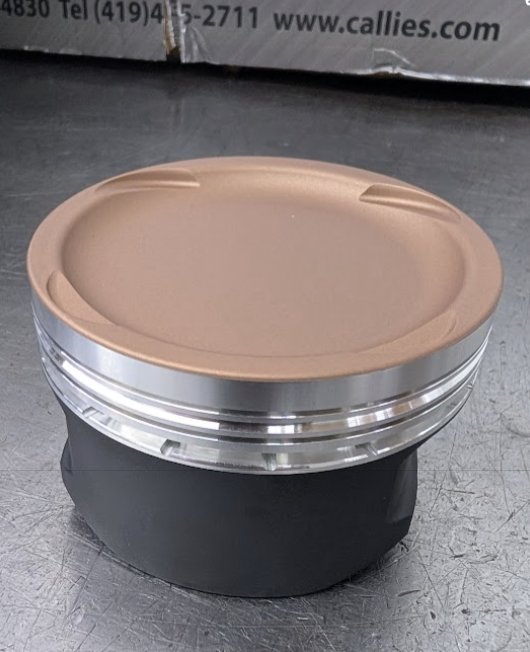

    These took for-freakin-ever to get made but oh boy are they pretty...

    5 months right on time. :D
    Got everything else in hand?
