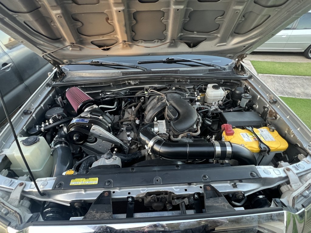

    My 2014 w/Procharger fits fine with the air injection system.
    Torspd and boostedka[QUOTED] like this.
