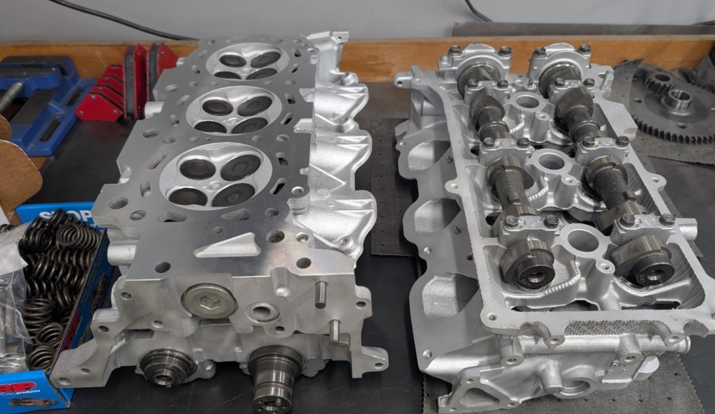

    PhoS
    PhoS Proffauxssional
    Apr 8, 2020
    #324146
    1,293
    PNW
    08 FJ Cruiser
    Contains MSG
    Refreshed heads with Kelfords.

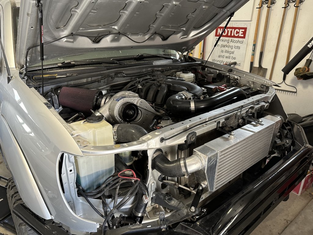

    I finally got some time to install the procharger kit. I’m stuck on the dumbest thing, moving the dipstick. I cannot for the life of me get the bolt to line up with that spacer in there. It seems like I need the bracket to move down and to the rear of the vehicle slightly. Any tips?
  17. Mar 23, 2025 at 3:35 PM
    #877
    PhoS
    Apr 8, 2020
    #324146
    1,293
    PNW
    08 FJ Cruiser
    Contains MSG
    Make sure you got the right bolt? Says M6 x 55mm. I don't recall anything special about installing it though sorry..

    It’s the right bolt. Threads in when not going through the bracket. But not when it’s in the bracket. Idk

    I ended up using my dremel to bore out the hole on the bracket a little bigger. Almost there. Just need a few little things: t bolts clamps for the rest of the piping, a mounting bracket for the air injection pump, supercharger oil, and the OTT tune.

    Did you weld a tube to the inlet of intercooler? Or did it come like that? I wish mines came like how yours is would have been easier to connect the rubber hoses instead of trying to fit two 45 deg
