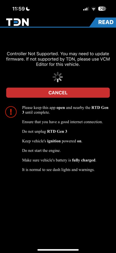

    For some reason I can’t figure out, my RTD won’t read my stock tune with TDN. Firmware is up to date. I don’t see VCM editor anywhere in the App Store. Any suggestions?
    This is what it shows on screen:

    JustDSM
    JustDSM Oderint Dum Metuant
    Jan 16, 2015
    #146525
    3,313
    Justin
    Ogden, UT
    The TDN network doesn't work for Toyota controllers (last we spoke with HPT). You'll need to use a Windows based laptop and use "RTDFlasher" program to read your truck.
    Did ProCharger advise you to use TDN?

    Yeah. I tried using the RTD flasher and couldn’t get my laptop to see it when connected to usb. I called Procharger and the guy told me to use the TDN app because he said there’s no longer support for the windows program. Any tips on how I can get my windows 10 laptop to pick up the RTD? Thanks.

    So it sounds like the TDN app was able to communicate to the RTD via bluetooth on your phone? It just won't read the ECM?

    That's correct. It's connected to my phone but then says it's not supported when I try to read the stock ECM tune. I just want to run the OTT tune, but my local OTT guy say I have to run the Procharger tune first before he'll load the OTT tune.
    Truck has been done, just sitting in the garage needing a tune to load.
    I used that same video to set up the RTD on my phone

    Send us an email and we'll get you the software you need to load your ProCharger tune if they didn't provide this to you.
    Please mention your situation and that you need the RTDFlasher software after speaking with JustDSM

    The TDN app wont work for Toyota, I'd save your energy. We'll send you the proper software.
