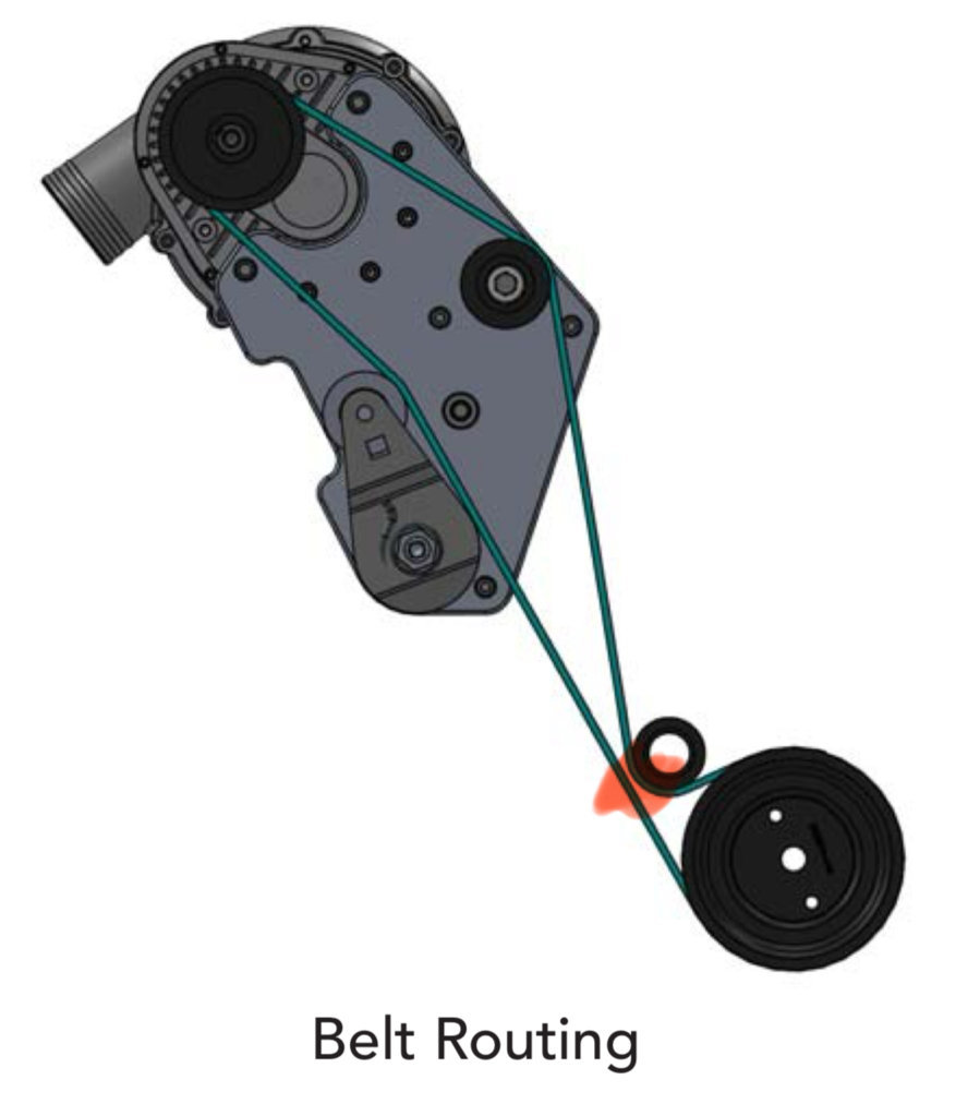

    Thanks. Same “stock” belt and all? Abut how much space is there between the belt on the idler and tensioner pulleys?

    Yes stock Bando 6PK1790 , distance between which two? The tensioner is around an 80deg angle. The tensioner on these doesn't need a ton of pre-load.

    Space where I put the red dot on the diagram:

    I see , I would call it about 10mm. That pulley is different than depicted in the diagram and has tall ears on either end and is smaller in the middle.

    Ok good to know. Mine has about that much space as well. Thanks for the info.

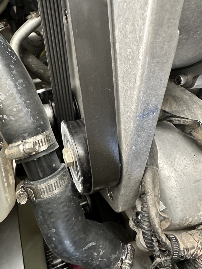

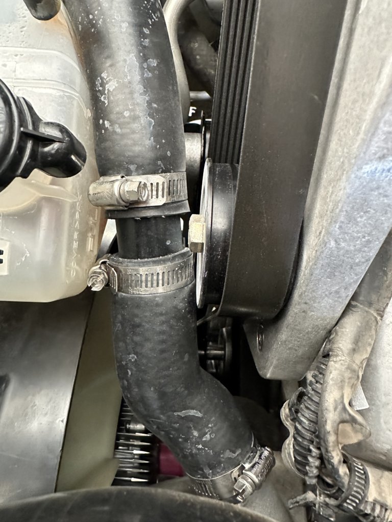

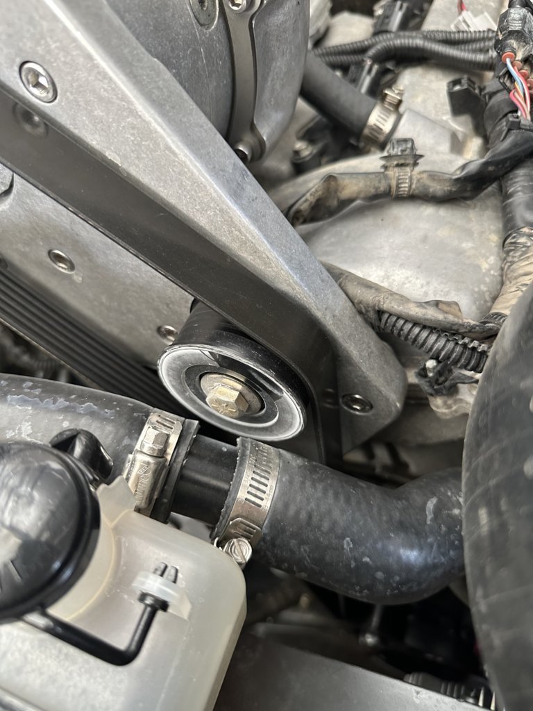

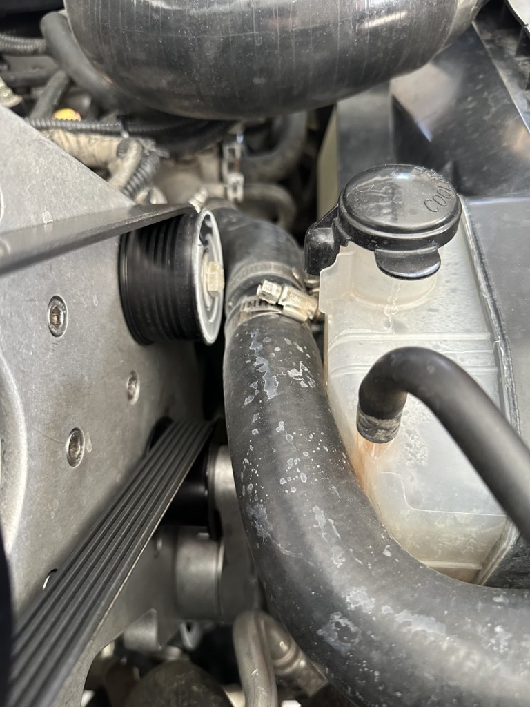

    It seems this idler pulley is rubbing on the radiator hose clamp when the motor shifts. Any suggestions on how to remedy this?
