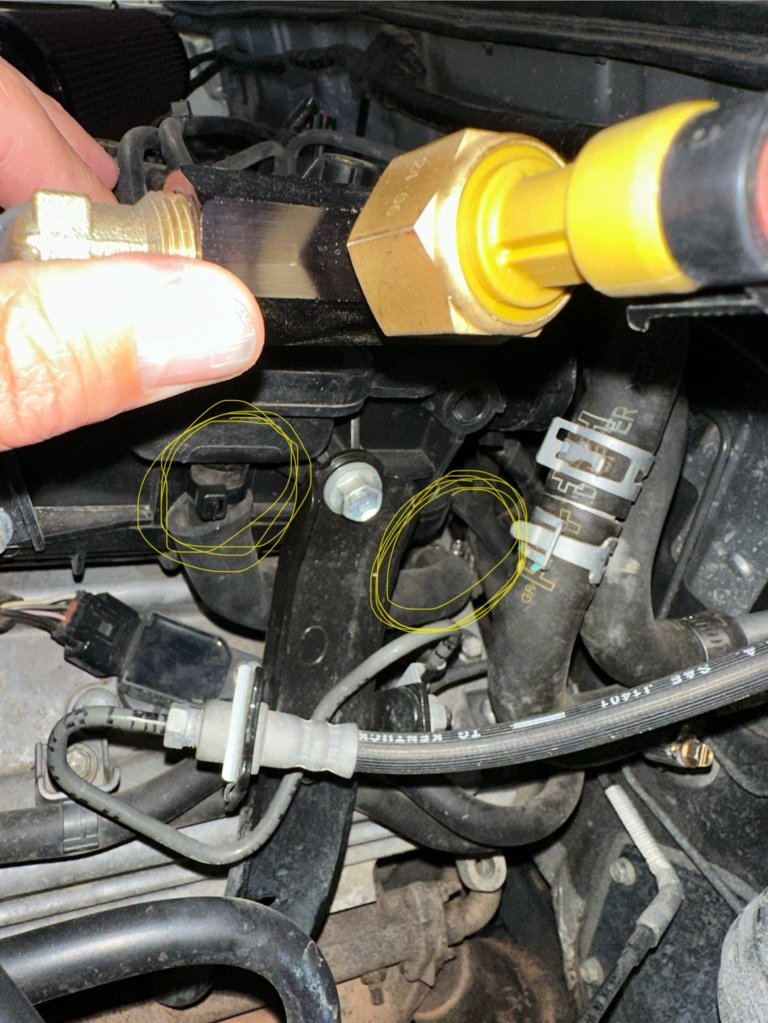

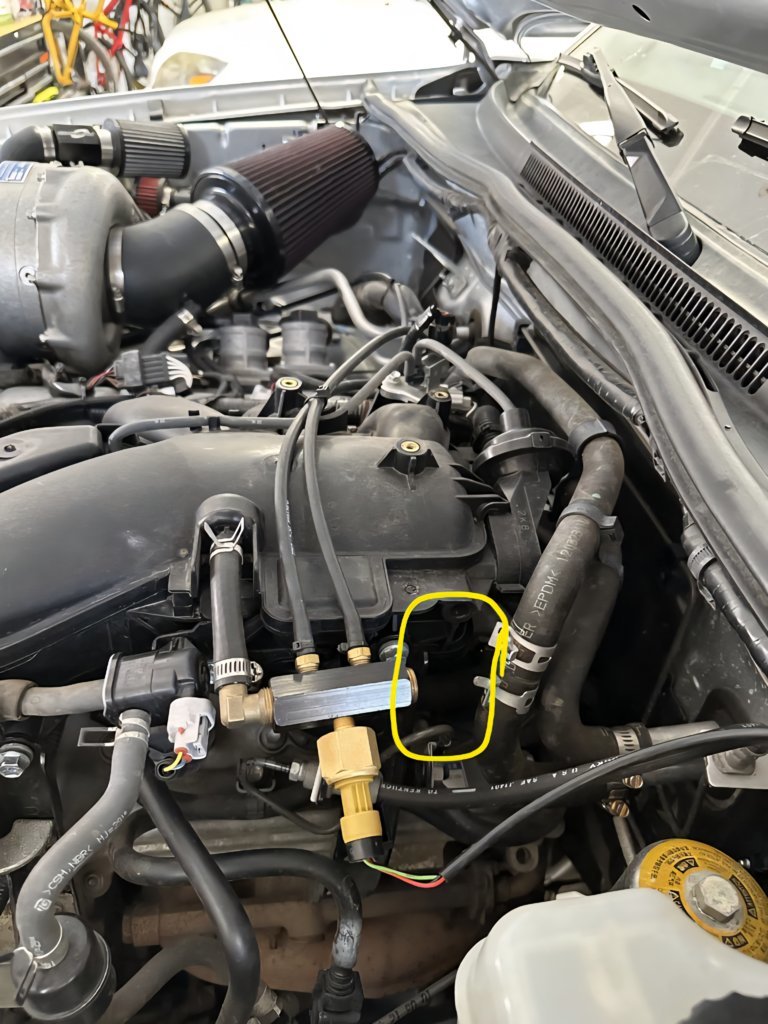

    Hard to tell in your pic, what did you do with the pcv hose that connects to the intake just under and behind the procharger vac manifold from the valve cover? Kind of looks like just the nipple there?

    This pic make it easier to see? I circled the connections to the pcv and the intake manifold. One has a hose clamp, the other is zip tied

    I replaced the zip tie with a hose clamp. Did the same on the main connection to the intake manifold as well. Feels like the truck is boosting well. It seems like the guage is just not seeing it. Should each of the ports on the little vac mani see boost pressure?

    Yea man, like I said it's probably the sensor. Give AEM a ring, they'll send you another one.

    I pulled the pressure sensor off the little mani and left it plugged in to the gauge. Then pushed a small amount of air into it with my air compressor and it read 5psi

    You would have other issues if there was vacuum leaking somewhere. (bad idle, etc) The SC would still make some boost even if there was a vacuum line missing for example. It would have to be a major disconnect like intercooler hose or something to leak enough airflow to show nothing.

    I hooked up an autometer mechanical boost gauge. It showed ~2psi at lower rpm and ~5psi at 4.5k rpm

    Yea I still think you have a bad sensor, like I said they're known to be flakey. Blowing air in with a compressor should spike it to a high level instantly.

    That makes sense. I’ll call them today and see what they say. thanks for all your insight and ideas.
