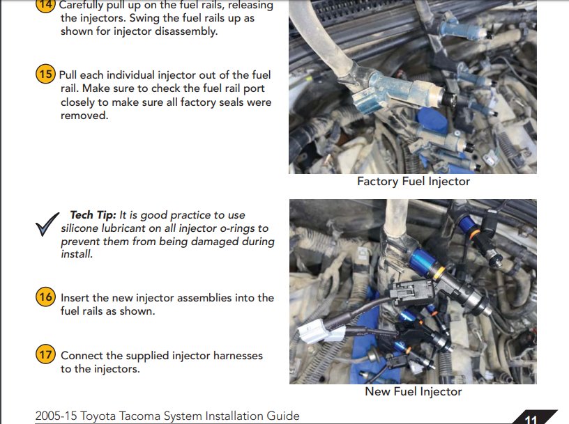

    Looks like FIC injectors maybe? Also I notice it is using adapter harnesses for the injectors, and they do plan on getting the kit carb approved. See @12TRDTacoma no need to be scared of injectors!

    I'm not afraid of adapters because I won't need them if and when it's time. ;)

    IIRC they told me they used 51LB injectors in the full kits. (gen2)

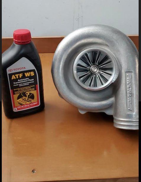

    This thing is freakin massive!
