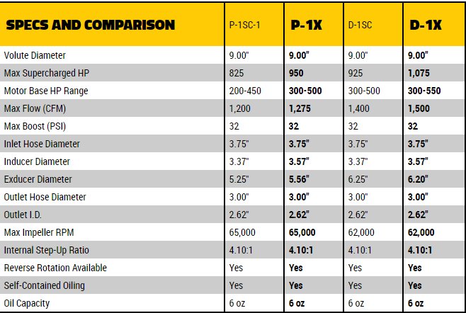

    So I was browsing prochargers page for probably the 100th time because I'm inpatient at looking at the kit helps hold me over, and I noticed that the two tacomas they have installed kits on have two different head units :confused:
    https://www.procharger.com/gallery/1211/2016-toyota-tacoma
    https://www.procharger.com/gallery/1214/2010-toyota-tacoma
    Anyone know why they would do this? I looked up both the superchargers and found this post on a mustang forum
    https://www.mustang6g.com/forums/threads/just-a-heads-up-p1sc1-vs-d1sc.60972/
    I also found this chart comparing the two. The website for the actual kit lists the D-1SC but the black tacoma that they use for promo pictures uses the P-1SC-1. Even though the P-1SC-1 looks like it puts out more HP on their install doesn't it seem like the D-1SC is the better unit? Please correct me if I am wrong though!

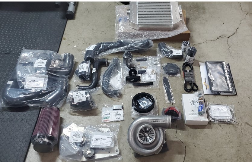

    I got the 5-15 Tuner kit with D-1SC(helical gears). It came with everything except the HP tuner, fuel injectors, and pump booster. I opted for the winch style intercooler but it would require some major hacking to get it to work on my FJ with the All Pro bumper so i'm doing air/water instead. (If anyone is looking for a really nice air/air intercooler LMK.)
    I can post some pics of the kit later, it's in a GIANT box and I haven't had time to tear into it yet.

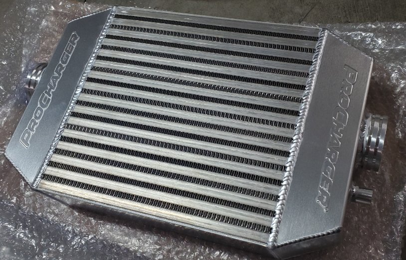

    I am curious what their intercooler looks like.

    Yep, it's a bunch of hoses & $hit. :rofl:The intercooler is 18.25 x 10.5 x 3, a weeee lil laddie. They included some extra oil kits for a few changes. Everything is nicely packaged and looks to be nice quality.

    That's a big looking and good looking intercooler.

    That's the one intercooler I got to see when I went up to their shop! Mine is the non-winch version so longer but not as tall
