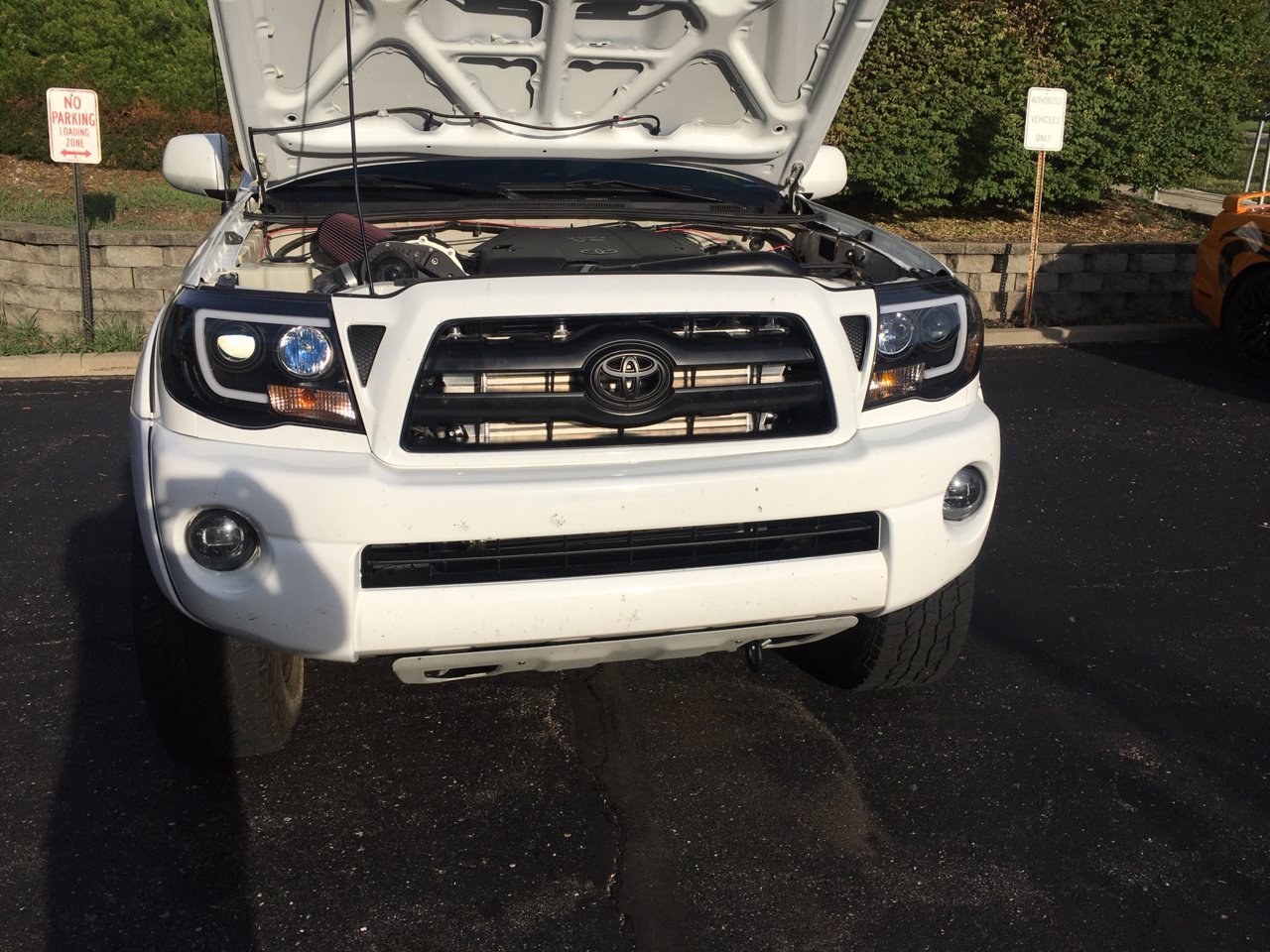

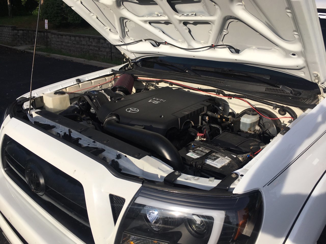

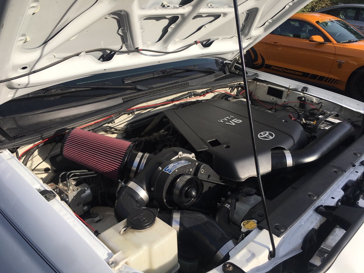

    Got the email today that the truck will be back on monday :D It was supposed to be Friday but he says he has a few more things he wants cleaned up and I'm getting a 400 dollar discount for the delay so I think I'll manage. Here are the first of many pictures for you guysIMG_9271.jpg IMG_9272.jpg IMG_9270.jpg

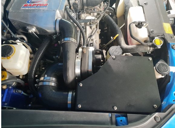

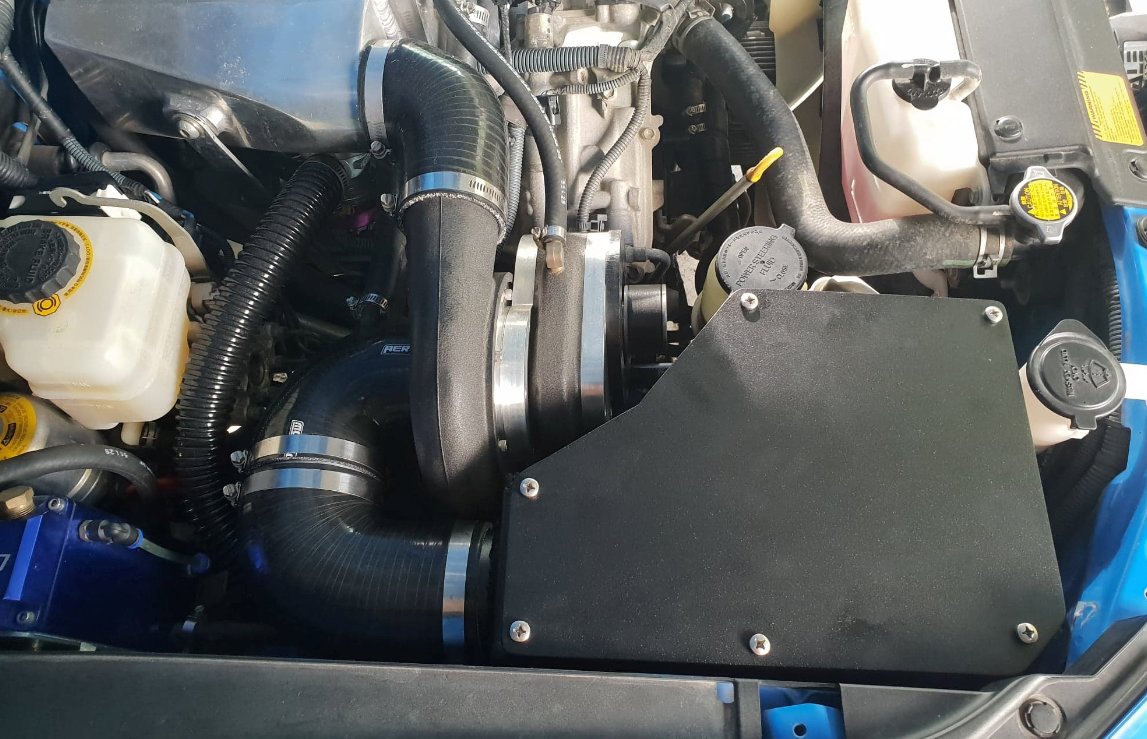

    The air intake isn't very elegant, I have been scouring the web for other ideas. I'm gonna do something like below. The inlet on the D1SC is 3.75", silicone adapters/reducers are proving super hard to come by in that size.
