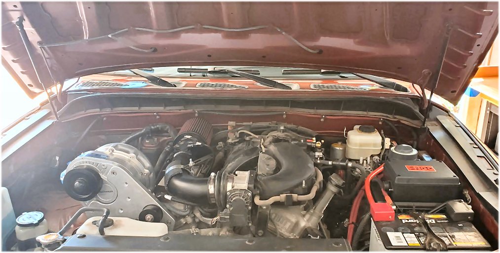

    Getting close! After some hurdles headers and exhaust are done. Had to make a temporary ghetto intake so I could remove my AFE airbox for space. Once that was out of the way I got the SC bracket in and all the ac lines and stuff relocated. The Procharger looks insane in there! I'm pretty sure i'm out of stuff to order at this point. Gotta wrap up some intercooler bits and finish the charge piping, then we goin boostin. :bananadance:
  14. Aug 15, 2020 at 5:40 PM

    Is their MAF housing 3"?

    Yes, why do you ask?

    MAF calibration. Knowing the I.D. tells me what the transfer function should be (approximately).
