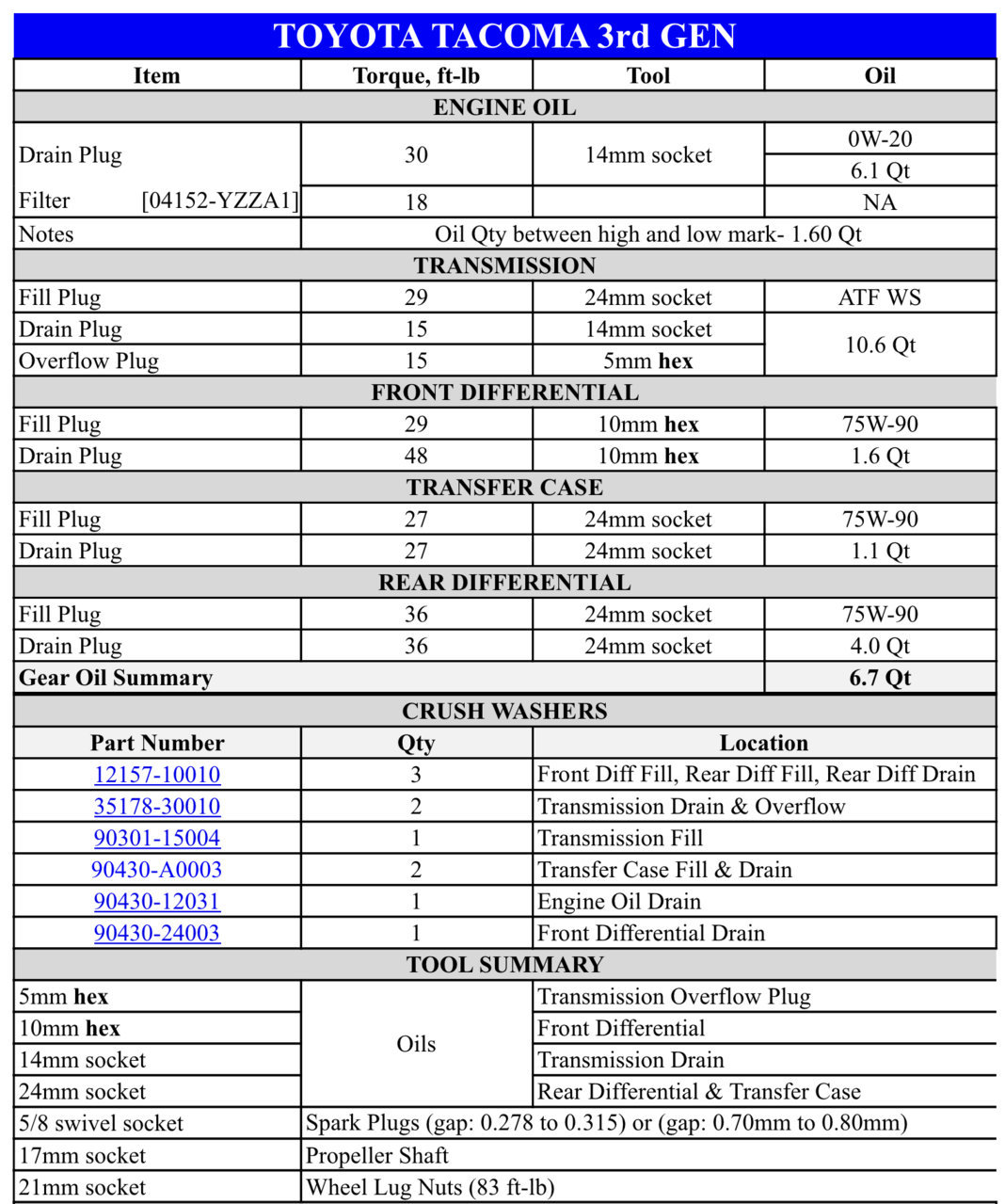

    Doesn’t look like the Google sheets worked out so I’m attaching the file here for anyone.

    Besides the oil filter is everything else the same for a 2.7L?

    Suspect different oil capacity, different spark plugs. Maybe not, but that's what owners manuals are for. When you download his file, just edit it for your truck.
    Manual trans folks will have different info too.

    You have the incorrect fluid specification listed for the transfer case. It is a straight grade 75W oil.
    SAE 75W Toyota Genuine Transfer gear oil LF or equivalent - Toyota part # 08885-81080
    The differential specification is 75W-85 although most folks seem to have no issues with the 75W-90.
    Other than that - nice job! :thumbsup:
