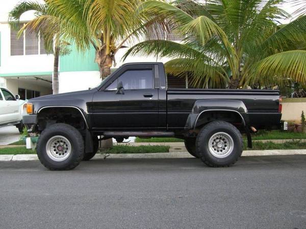

    Remember the longevity of a oil pump is not measured based on how much qts your engine uses is based on how many hours it's benn pumping oil.Nomatter how much oil you have in your engine 6qts or 8qts, the oil pump is going to be pumping oil anyway .
    Based on experience my toyota 4x4 1988 pick-up has 200,000 miles on it and only changed the timming belt (chain) once witch is recomended by toyota every 100,000 miles and if you change it they recomend to change the water pump and the oil pump as once
