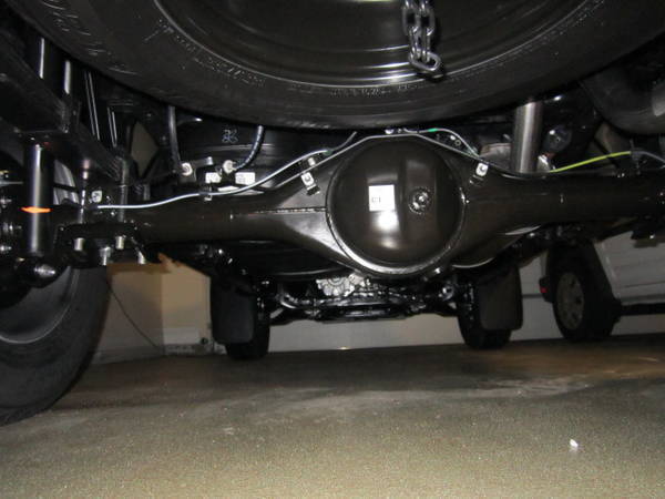

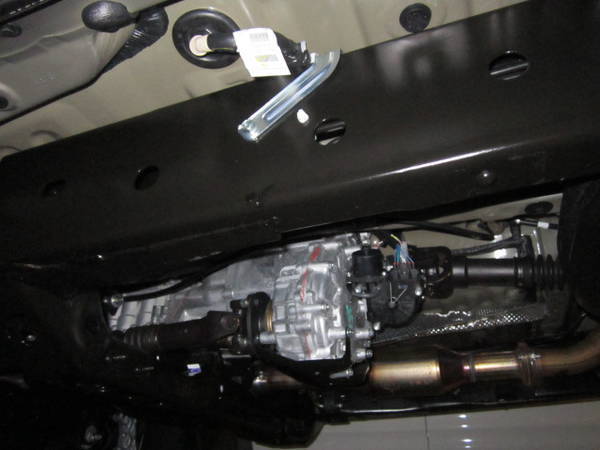

    My god, all the clean frame photos. Looks great, do you people actually drive your trucks?:D

    I have only had mine a little over a month, with 500 miles put on.

    No, My 2012 is still holding up great. I'm thinking about doing a touch up treatment every three years. Remember I sprayed the trucks when they were brought home from the dealer new so nothing was rusty or oxidized yet. I just posted this because it's been working me so far and wanted to share. Thanks.
