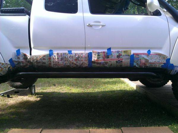

    Sure is pretty:D

    Hey Ding just saw your post. I use Rhino Ramps and 4L too but just for the front end. Do you do the front then back off, move the ramps and back up onto them to do the back ? If so do you find an advantage to just doing the whole joy at once ? Thanks for any reply.

    I was wondering how salt water would get into rocker panels and doors and if you guys treat them when you do your frame ?

    Thanks for the reply. I'm a little slow - how exactly do you get it on ramps front and back at the same time ? Thanks.

    put ramps in front of each tire and drive up (4x4 advised if wet).
    I only have two ramps so I drive up my deck :D

    Thanks for the reply. I'm a little slow but I got it now. I'm going to have to invest in another set of ramps - no deck that close to the ground. Just ordered my second set of ramps from Advanced Auto Parts. Use discount from TW thread. Thanks for the picture too. Looking forward to to working under my Tacoma with front and back up in the air.

    I would never be under a car with rhino ramps at least a truck is tall enough if they give out. Way to many documented cases of them collapsing or forming cracks. You are typically one for safety and correct work methods.
