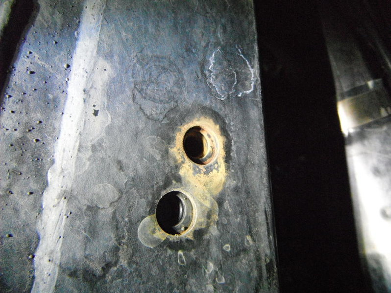

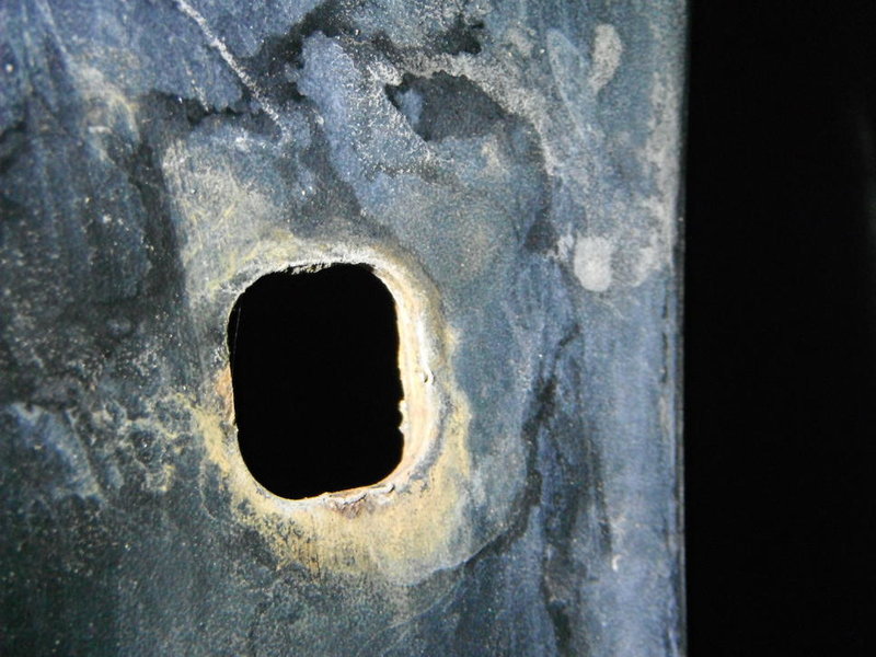

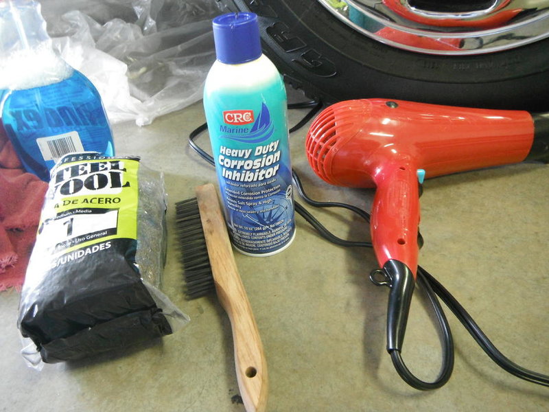

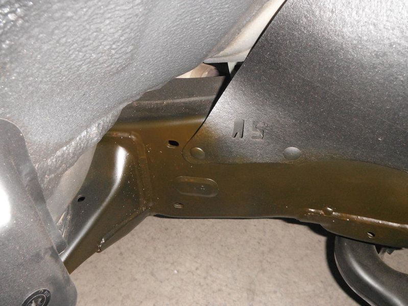

    Like many of you I purchased my Taco with the intent of keeping it for a very long time, hence I was a concerned to find a few small rust spots on the frame of my '13 AC (only 4600 miles). Several threads on TW indicated many Dana-made frames before 2009 were rusting prematurely and that Toyota had fixed the problem, so I thought my '13 might be somewhat more immune to rust. But I'm not taking any chances. Perusal of TW and other forum threads reveals a wide discrepancy of opinion on the efficacy and materials used for rust prevention. Since I cannot discern any consensus regarding rustproofing and I currently dwell in a state that doesn't salt the roads, I've decided to take a moderate approach and just regularly inspect and spot treat any rust for the foreseeable future. If I relocate to an area that salts the roads, I may reassess my strategy and get full undercarriage rustproofing, but for now it's creep and seek.
    I've decided to try CRC Heavy-Duty Corrosion Inhibitor, it passed a rigorous salt water test and was rated as one of the best rust preventors according to an experiment posted on:
    http://www.thehulltruth.com/sportfishing-charters-forum/123560-test-corrosion-inhibitor-sprays.html
    I cleaned the few small rusty areas on my frame with a wire brush and steel wool, then sprayed them with CRC. I then used the remaining CRC for a durability experiment; I sprayed CRC on unrusted sections of the frame adjacent to and just behind the front wheels. In theory the CRC might wear off more quickly in these areas due to more water and debris kickback; but time will tell, I'm curious how long this stuff will remain effective. I will continue to regularly monitor and spot treat rust for now, always looking for an excuse to ride the creeper!

    it is a combination of factors. The holes allow salt, water, etc to accumulate. The drains are very easily pluggged. The cats are right there adding heat.
    I would test some of this stuff out with some heat and see if it withstands it or melts away like a normal wax would. If it does I would look for another product for the boxed section of the frame.
