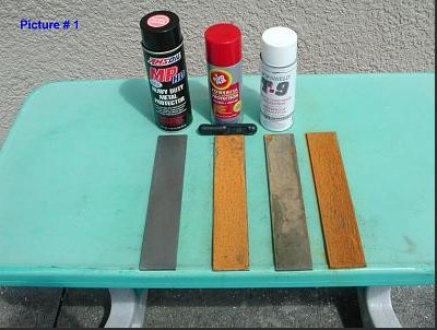

    I just want to bump this thread because I've been using this product since I saw this thread years ago. It truly is as good as it says. You do have to reapply it every year but I like that better than the Fluid Film because the Fluid Film creates a sticky mess.
    10/10 for Amsoil HDMP!
