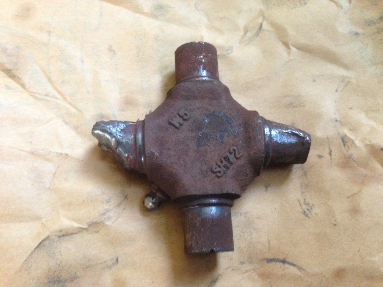

    This one was still hanging together.

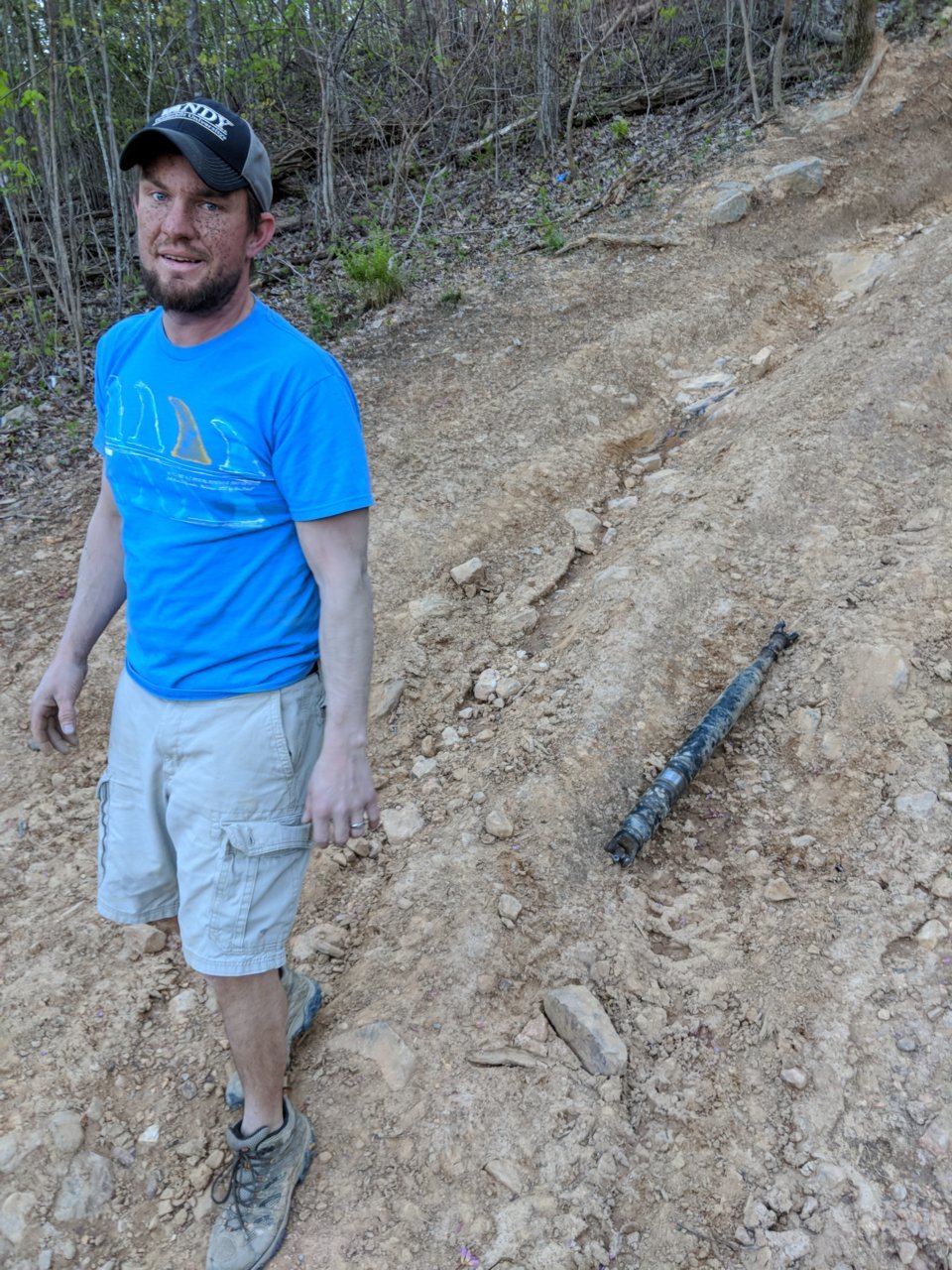

    Something happened and @Batman413 suddenly didn't have any power.. Lol u-joints fail, sometimes spectacularly sometimes unexpected.
