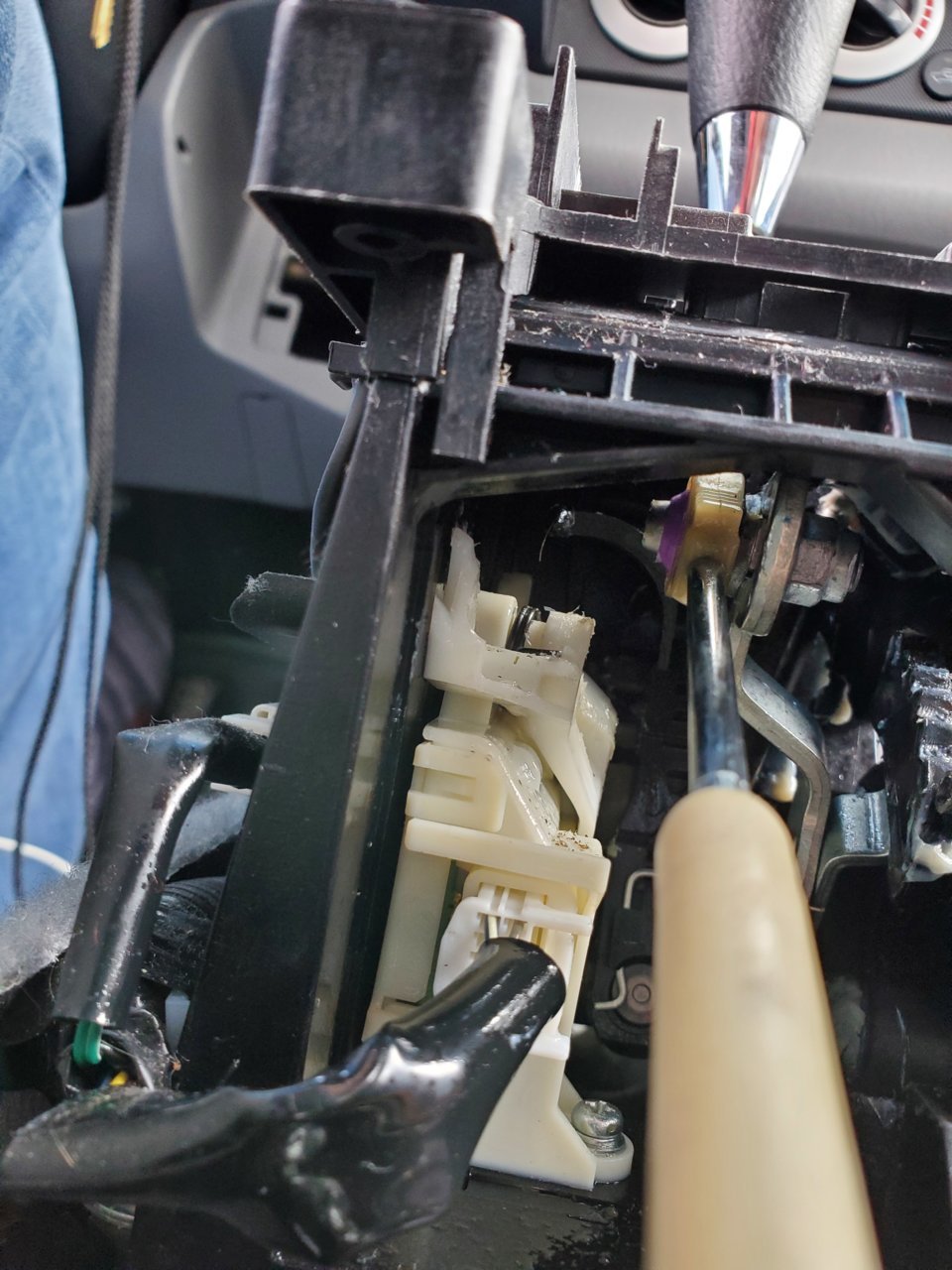

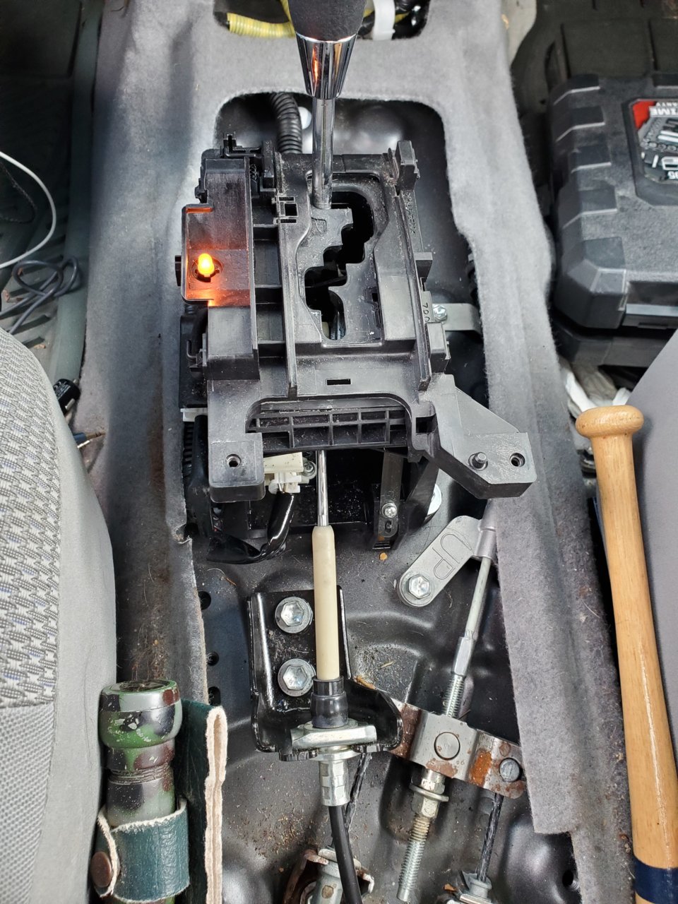

    All,
    My 2011 Tacoma 4x4 shifter cable is locked. The bushing popped off the gear mount so I purchased a new one and installed it. Now when I try to move out of park the cable is locked and wont allow it to move. See photos. Any idea what is going on? I try to move it while my foot is on the break and also by pushing the release button but the cable bar will not budge.
    If I force it from park to Reverse the bushing just pops off the shifter rod due to the cable not contracting or expanding.
    Joe

    He could attempt to use the shift lock bypass to get the cable moving again or un-bolt the shifter cable from the side of the transmission to verify the nuetral safety switch isnt seized up .

    2011 Tacoma
