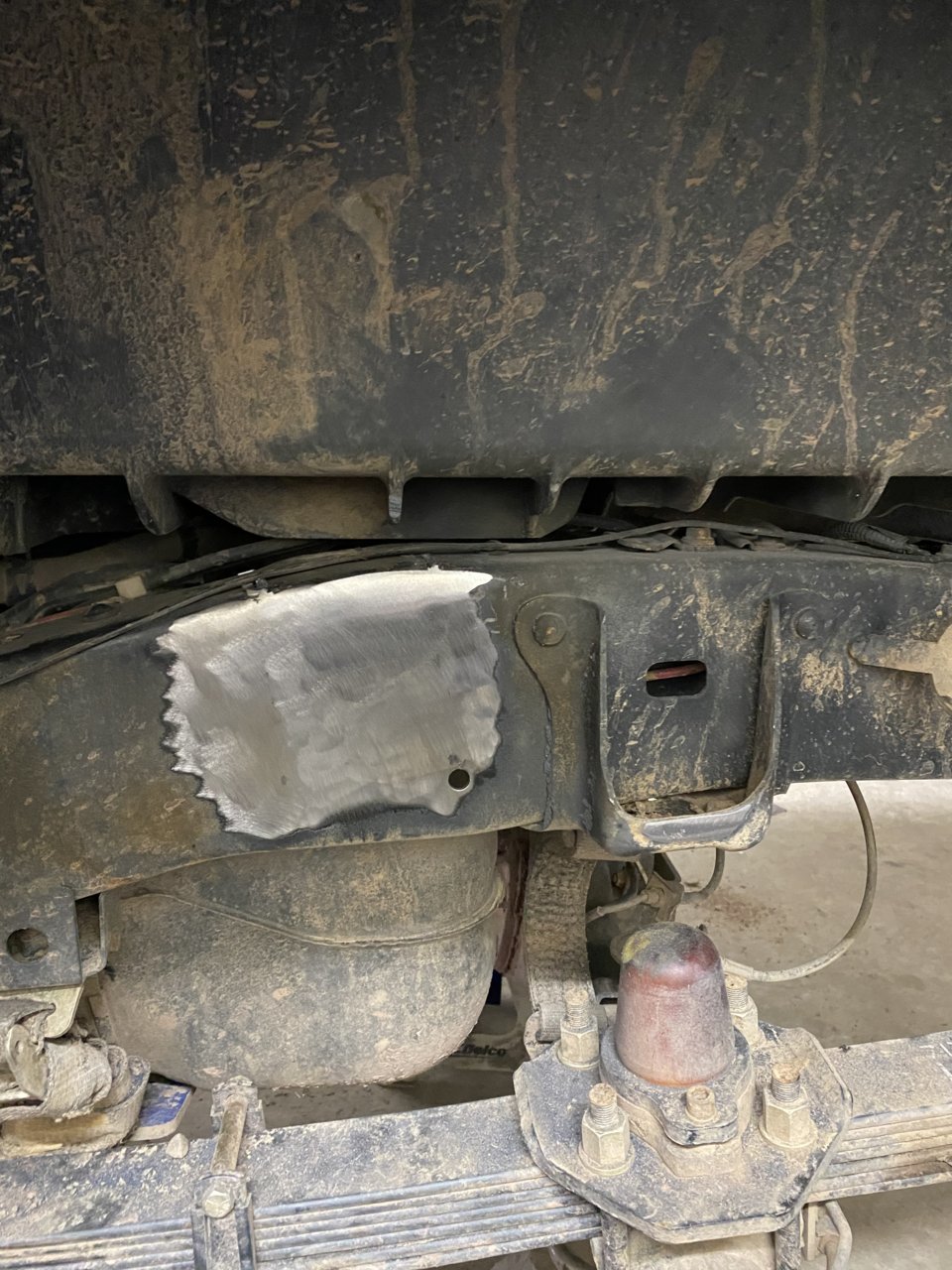

    34925E3F-B6B3-450C-9882-AFDB67264E02.jpgRelocation complete! Is a limit strap recommended?

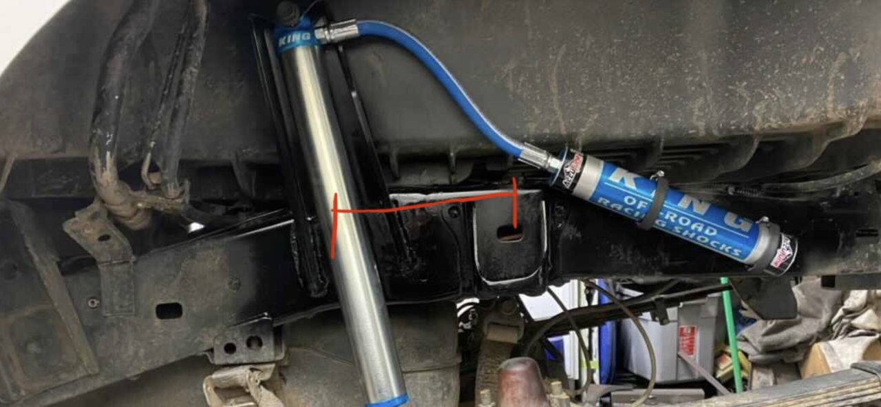

    Getting ready to do this next Friday. Is there a set distance/location we’re supposed to mount the tower? Example: a set measurement from middle of the strike pad to the middle of the new tower.
    I also don’t see a consensus on whether notching the drivers side — like on the other relocation kit — is required.

    Here’s what I did that worked for me.
    Tack lower mount horizontal
    Bolt shock into tower.
    Zip tie the shock shaft to the lower mount.
    Put a digital angle finder on the shock body and play around with the location of the tower until you get it as high as you can, shock centered in the tower, and shock has a 10° forward lean.
    Tack the tower in place.
    Move onto setting the lower mount appropriately.
    Tacking the lower mount horizontally just gets you in the ballpark of where it’ll be and it helps you get the tower where it needs to be.
    Hopefully this makes sense.

    Makes perfect sense. So tack lower at 0°, move shock on an arc until it has a 10° lean, tack tower, then grind-off the lower and rotate it until 1” of shaft showing at compression.
    Is there a set distance from the leaf spring perch to weld the lowers? I watched a video where they measured from a set point on the bigger relocate kit.

    Notching is not required on DCSB bed support bracket, just grind the weld flat to bracket, some have weld that bubbles out.
    Positioning forward corner of tower base under the rear corner of DCSB supprt bracket works nicely

    Yup, you summarized it perfectly. And I put the lower mount 1.5” away from the leaf spring perch.

    The frame rails are the essentially the same.
    Look at pics in post 1 of the DCSB, of Glenn and Mventure

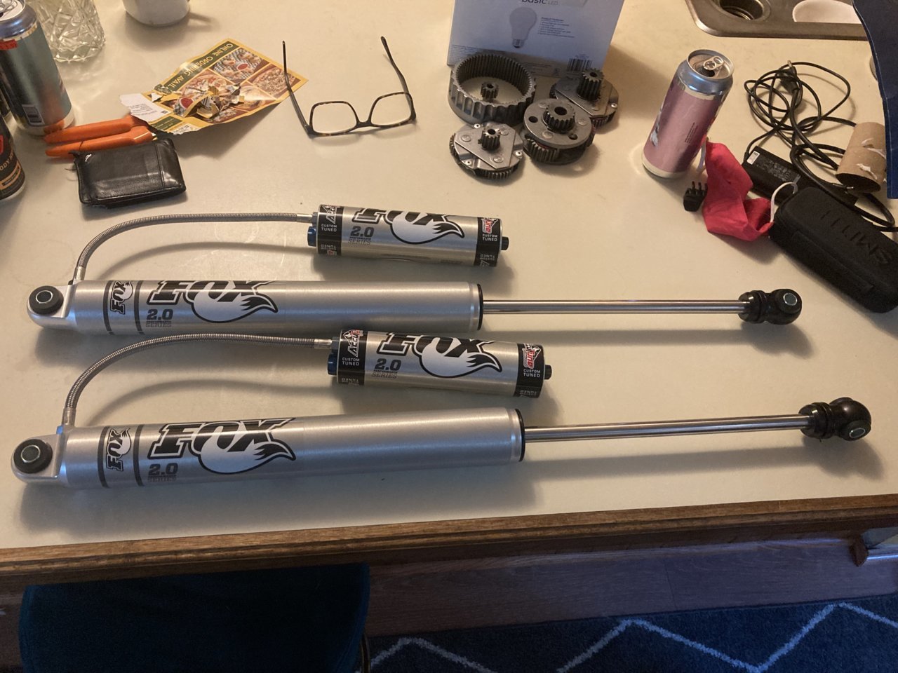

    These bad boys showed up over the weekend!

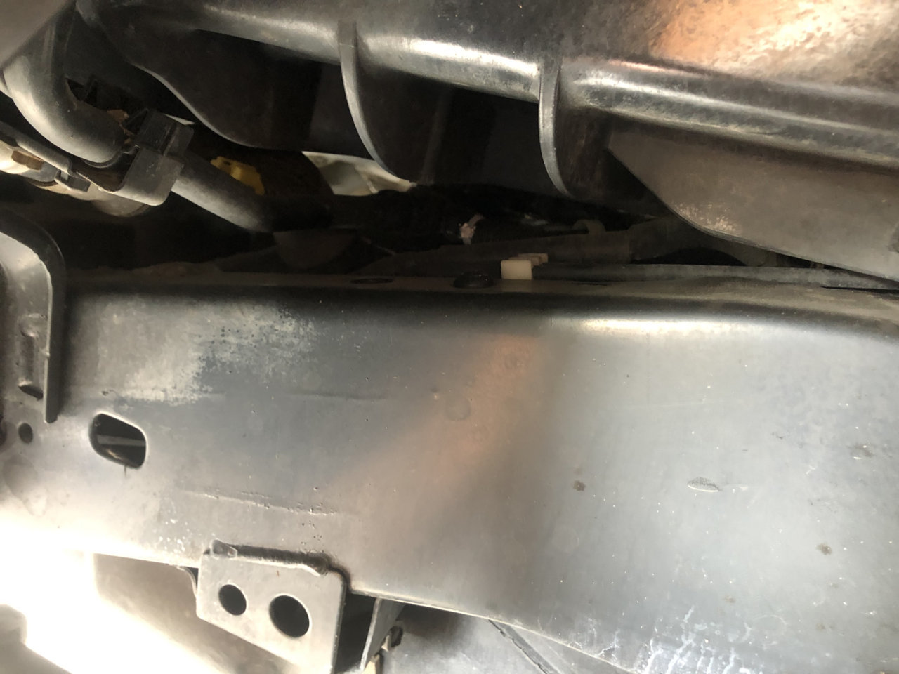

    Just some info for the knowledge base: The 3rd gen access cab doesn’t have that support bracket there to use as a reference. Here’s my drivers side which is clean along the whole top part:
    So doing the 10° forward tilt as @EatSleepTacos suggested seems like it might be an actual requirement for ACs. Not a lot of good reference points under there.

    When you say support bracket, are you talking about the bed mount? The thing they were talking about trimming? That’s just a short bed thing. Here’s my drivers side rail, second gen access can, also nice and smooth. Like you said, really no reference point over there.
  20. Aug 3, 2021 at 5:58 PM
