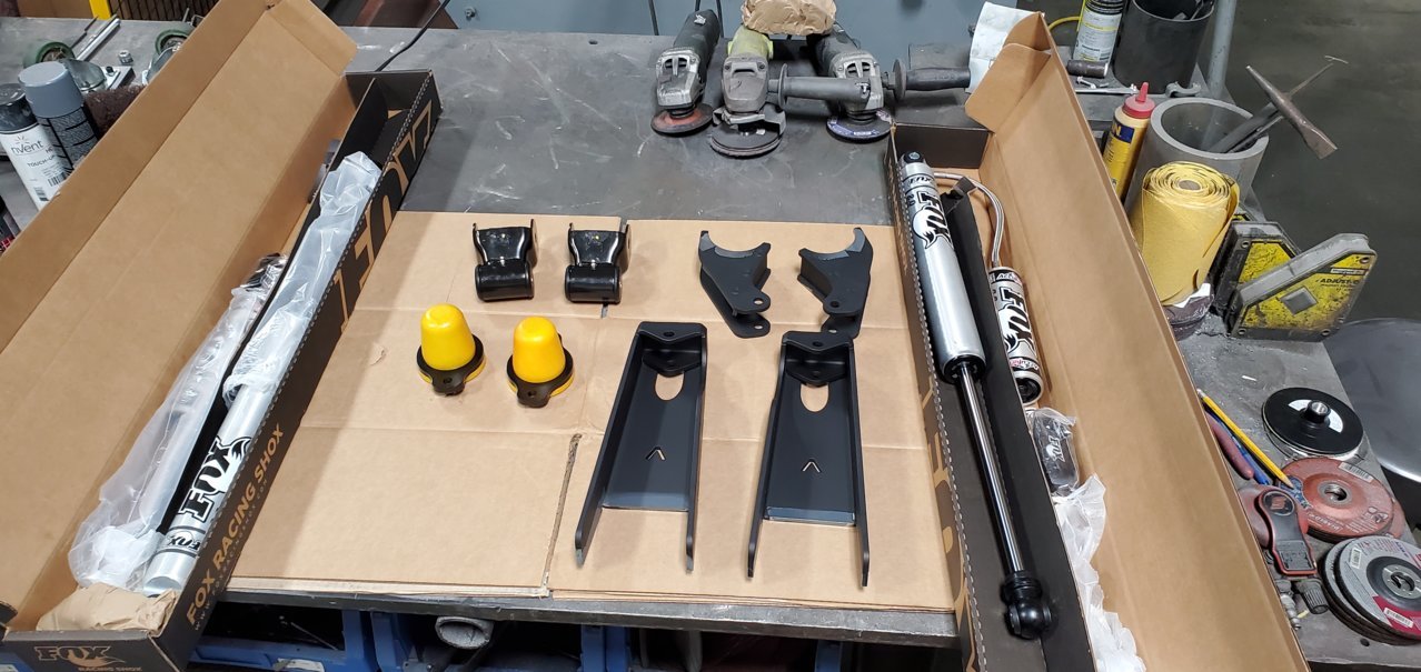

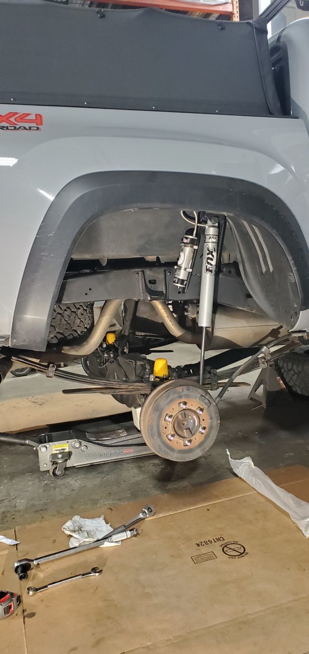

    Have the week off, so finally have time to get the relocation kit in. Soooooo here we go.....

    It has been done!

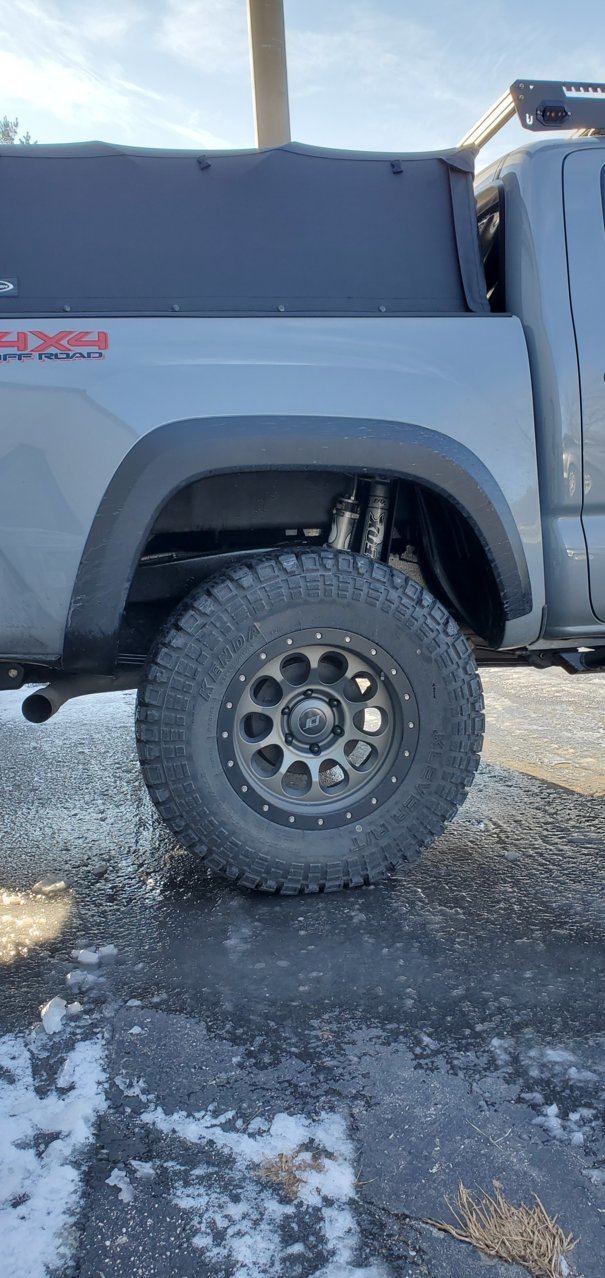

    DK if this has been discussed in here but thought i would share. 315 75 16 -12 offset slightly rubs the shock body at full flex. It didn't eat all the plastic logo off. Pic of that flex as well. :D

    Thank you for the input. From looks of your setup, are those 16x8 -12? If so that would be 4" BS
    We have this note on our website, added to post #1:
    -Wheel spacers may not be needed with negative offset wheels, depending on tire size and brand (ex: 16x8 et0 4.5" BS w/285s or 17x9 et-38 3.5" BS w/315s)

    Yes it 16x8. I am going to get some .25 wheel spacers most likely but need longer wheel studs. I just don't want to mess with it right now. Its not so pressing that i need to address right away. Plus it will only be when im fully stretching the trucks legs lol. That happens probably 1 time every 3 months or so. Glad that's been caught already lol. I knew it probably was going to be an issue when i put the bigger tires on :)
