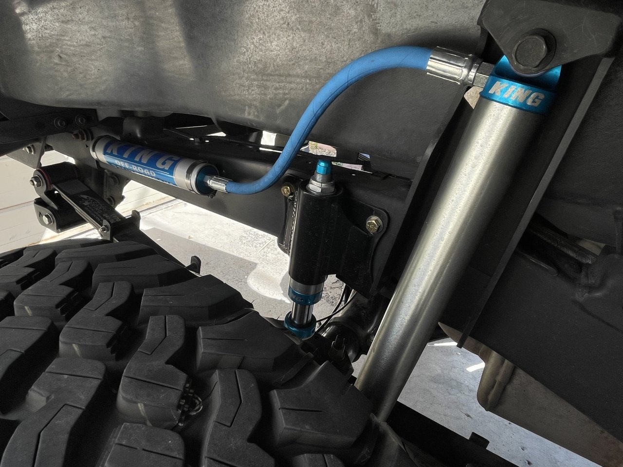

  3. Apr 28, 2022 at 10:35 AM
    #343
    ZebraScissors
    ZebraScissors Well-Known Member
    Oct 3, 2017
    #231922
    398
    Drake
    Reno, Nevada
    2018 Cav Blue TRD Pro

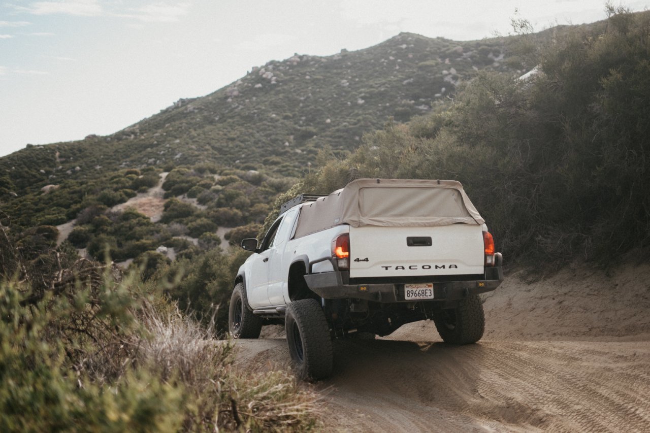

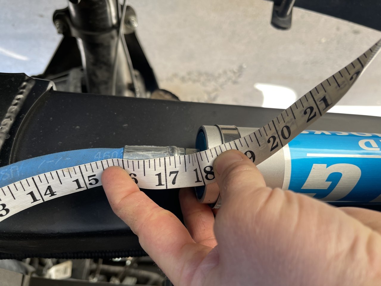

    Figured I would bump this thread a little, love my relos….. pro tip, order the shocks with longer res hoses if you are OCD like me and don’t want your resi crooked.
    Also if you are super tall and ultra heavy in the back like me…. 3.5-4”, do some measurements and consider 14’s. My leafs have a pretty aggressive swoop when at droop.
    Archive shit rocks… love it all.

  6. Apr 28, 2022 at 10:57 AM
    #346
    ZebraScissors
    Oct 3, 2017
    #231922
    398
    Drake
    Reno, Nevada
    Exactly end to end, she’s 17.5

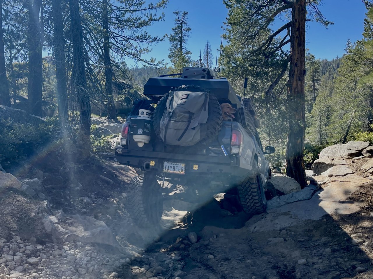

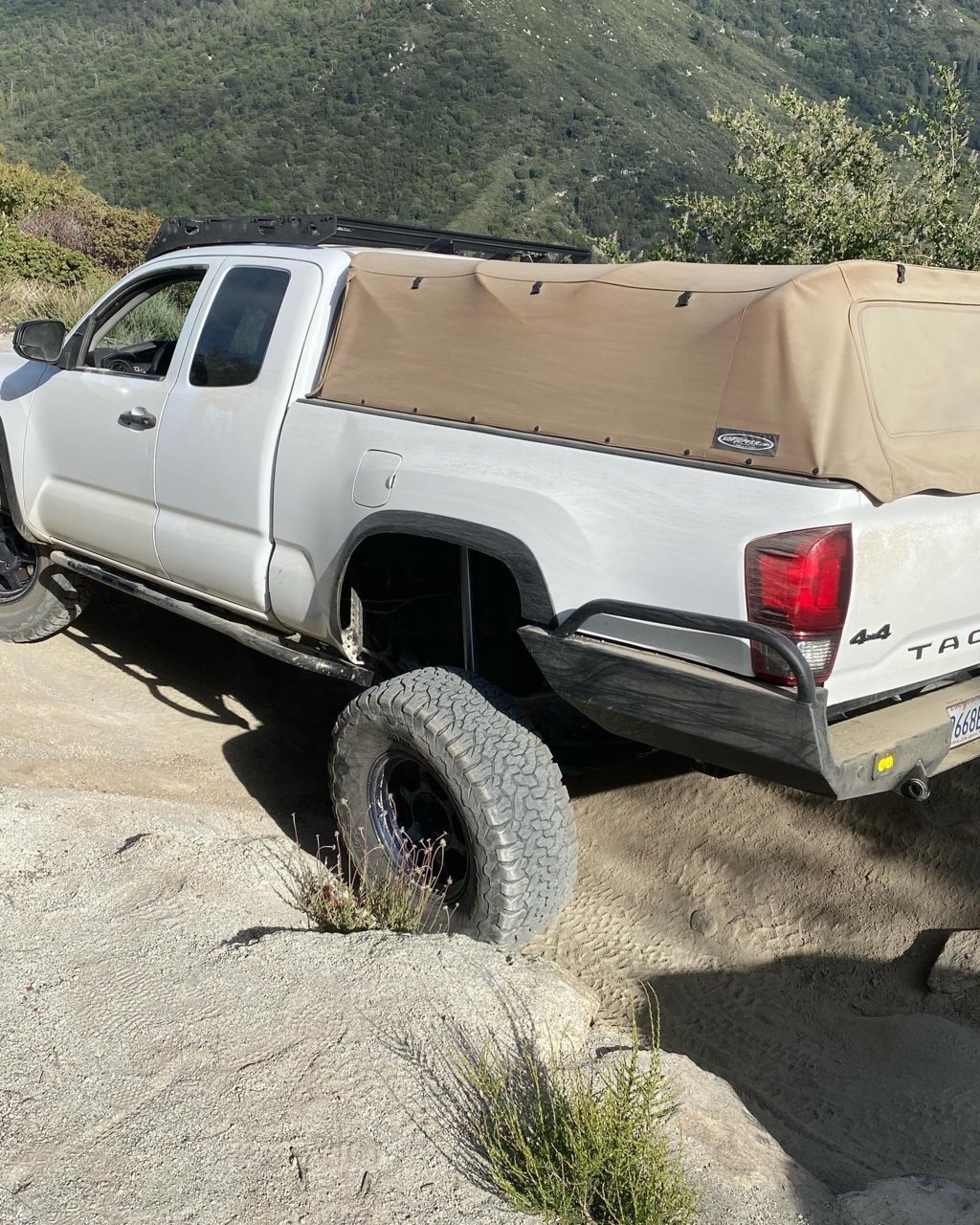

  9. May 14, 2022 at 8:49 PM
    #349
    Slidoomz
    Slidoomz Well-Known Member
    Dec 28, 2019
    #314459
    134
    David
    Riverside,CA
    Ford F150
    i tested out the new suspension.
    Flexy.jpg 4C791397-DDE4-4B74-83F8-6C5D244AF5C4.jpg C9EC590D-3A3C-4A69-BCF5-082EFC1C0484.jpg 3997F774-5FA8-4F60-A490-EF167938DF21.jpg

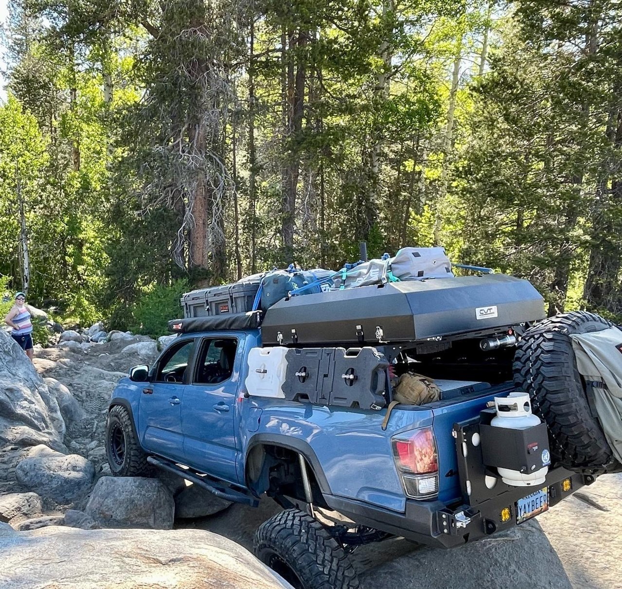

    #351
    ZebraScissors
    Oct 3, 2017
    #231922
    398
    Drake
    Reno, Nevada
    Tested mine as well. Performed like I expected, rock solid.

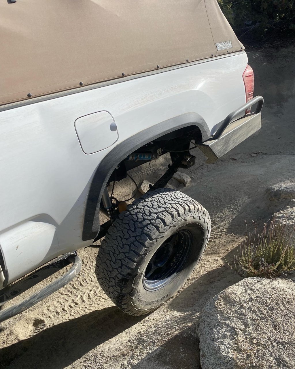

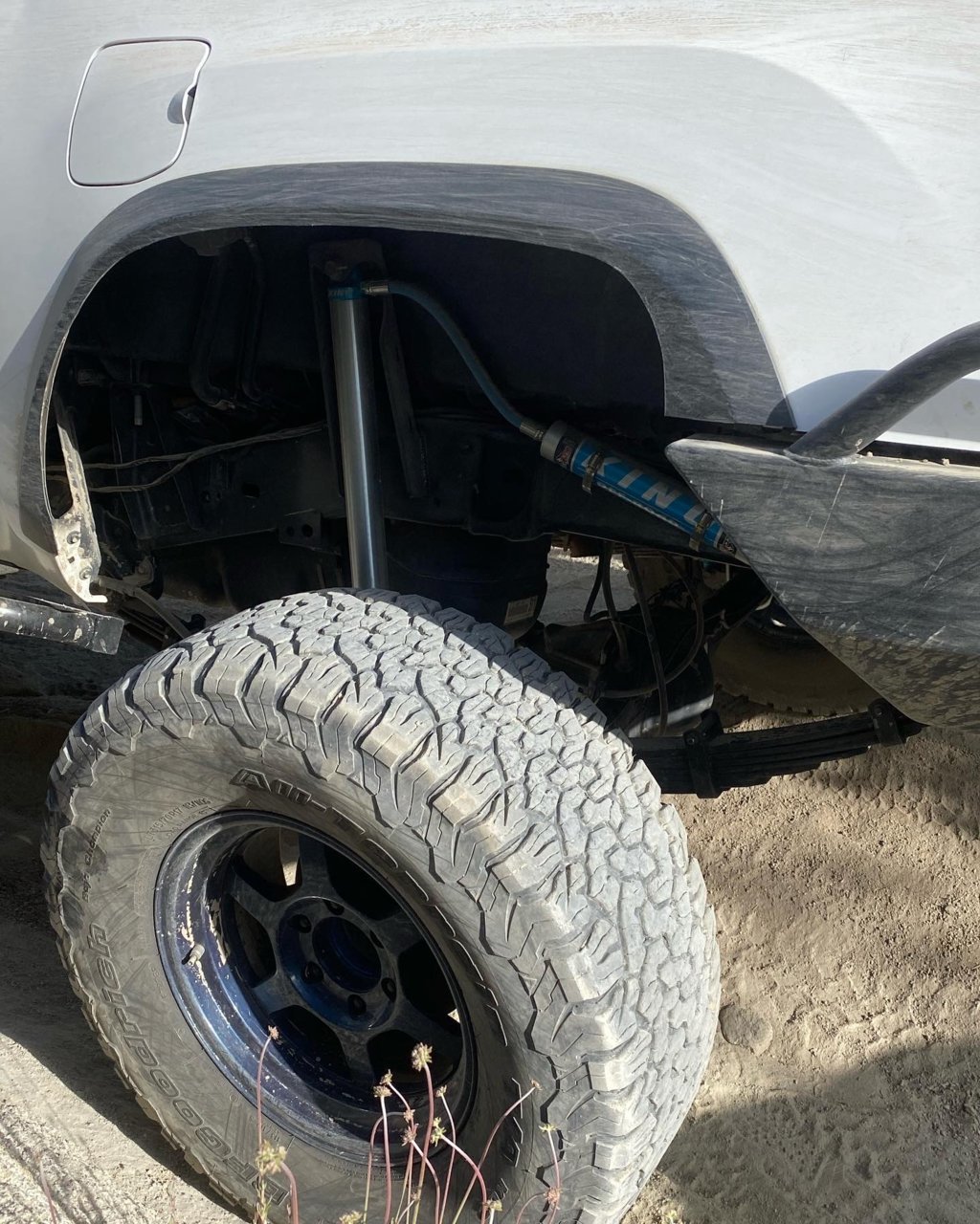

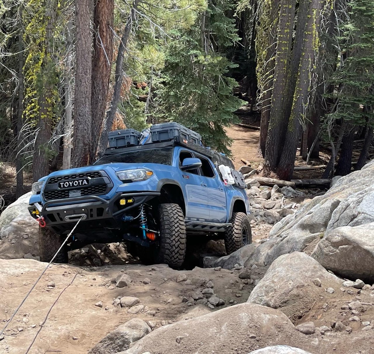

  14. Jun 20, 2022 at 9:32 AM
    #354
    ZebraScissors
    Oct 3, 2017
    #231922
    398
    Drake
    Reno, Nevada
    Just another example of what the kit is capable of, forgive the potato quality pic….
