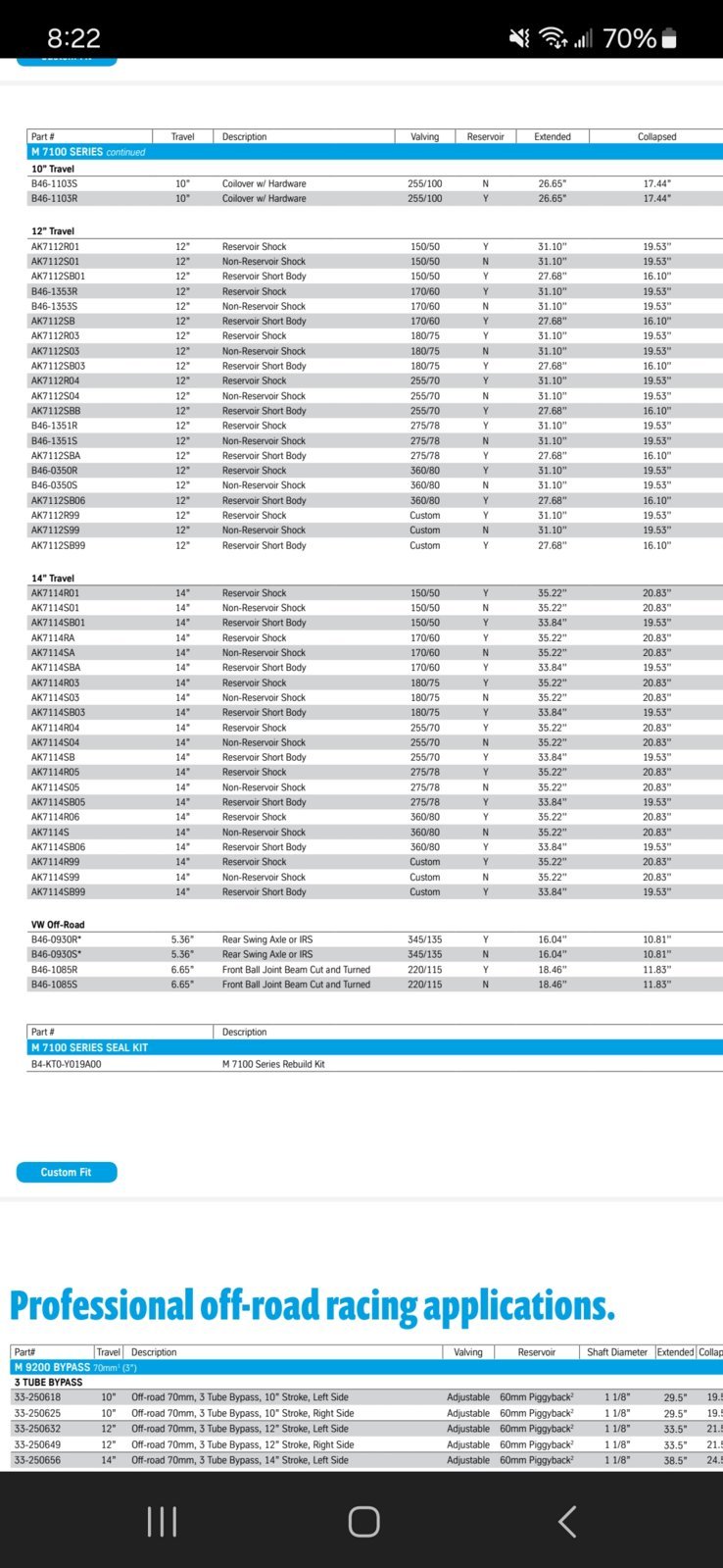

    Bilstein 7100 14” short body. 255/70 valving.

    That 7100 looks same price as the Fox
    might just email Bilstein be like Yo
    Do you have anything that’s like a longer 5160 for this
    Because the catalog didn’t seem to really show

    These two guys gave you the 2 options from Bilstein that would work 5125 or 7100. 7100 is more similar to a 5160 because it has a resi and isnt IFP

    The 7100 exists with and without reservoirs. Just keep in mind the the shock eyelets are thinner compared to other companies and you will need to make spacers for the bolt shock mount. Is was originally going to go this route but ended up going with bilsteins for the front and fox for the rear.

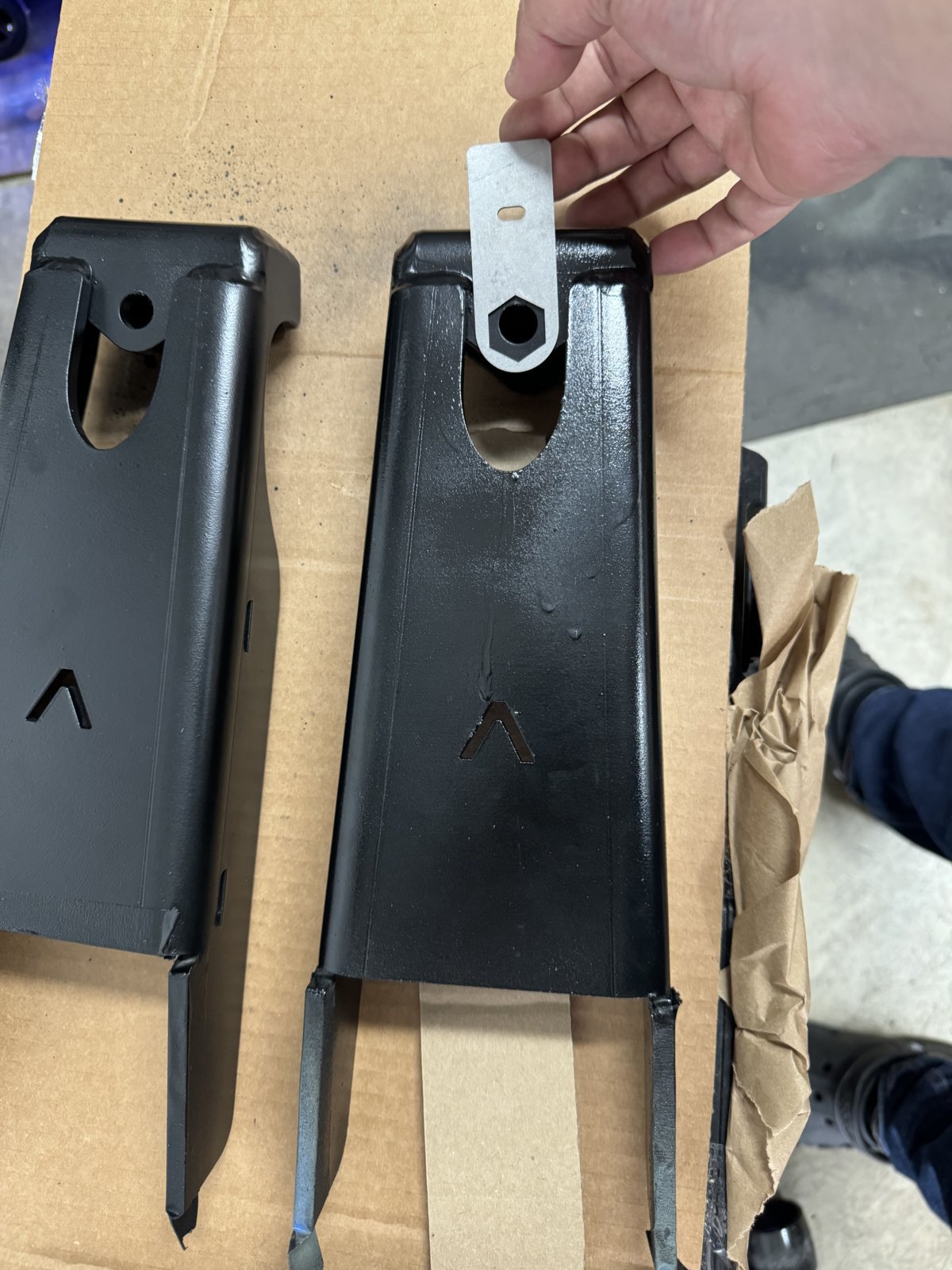

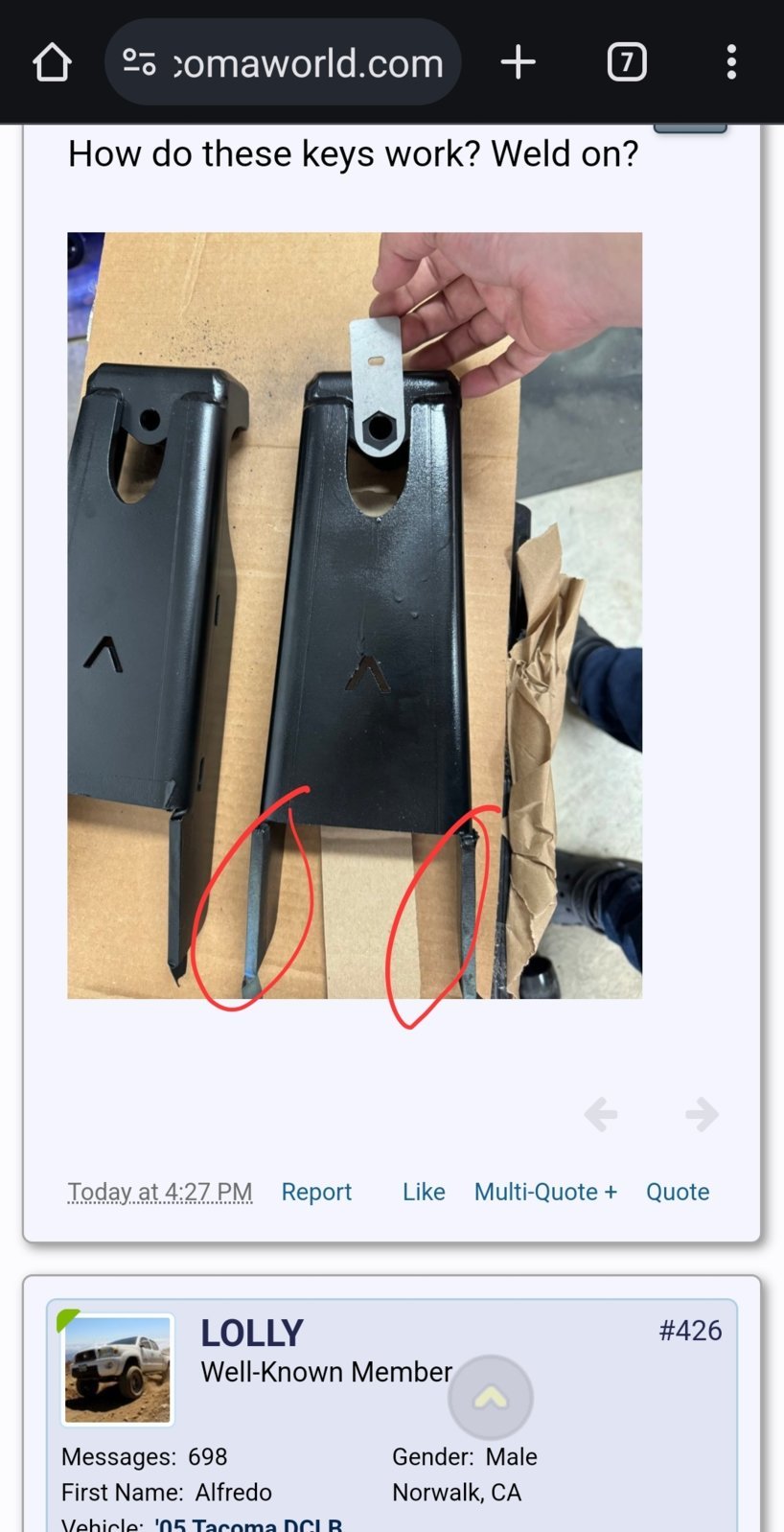

    Ashburn, VA
    2010 TRD OR Access Cab
    How do these keys work? Weld on?
    LOLLY likes this.

    LOLLY
    LOLLY Well-Known Member
    Oct 11, 2016
    #199547
    823
    Alfredo
    Norwalk, CA
    '05 Tacoma DCLB TRD Sport (RIP) Now '21 TRD Off-Road
    I bent mine in 90 degrees where the slot hole is and cut it so the tab part is about 1/4"long. Flat part towards the frame of the truck and the 90 degree part went through the hole of the shock relocation. The tab was 180 degrees from the way you're holding it

  7. Jun 5, 2024 at 7:32 PM
    #427
    LOLLY
    Oct 11, 2016
    #199547
    823
    Alfredo
    Norwalk, CA
    And these are the parts the get welded so you might want to grind off the paint
  8. Jun 6, 2024 at 3:38 AM
    #428
    fatfurious2
    Jun 28, 2014
    #132884
    49,800
    David
    Ashburn, VA
    Yes I know. Actually have that part taped off.
    Ill be replacing the BAMF shock relocate that Ive had installed for 5 years. I just like Archive better.
