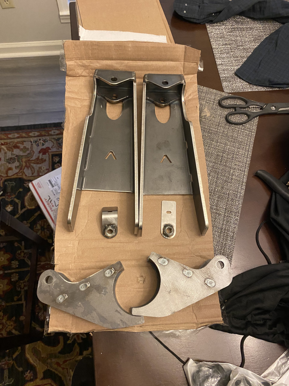

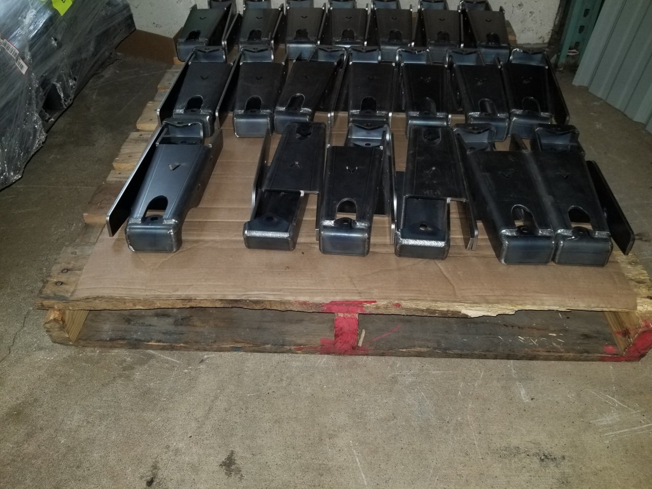

    Well some goodies showed up!

    Welded, I will contact people on the list shortly

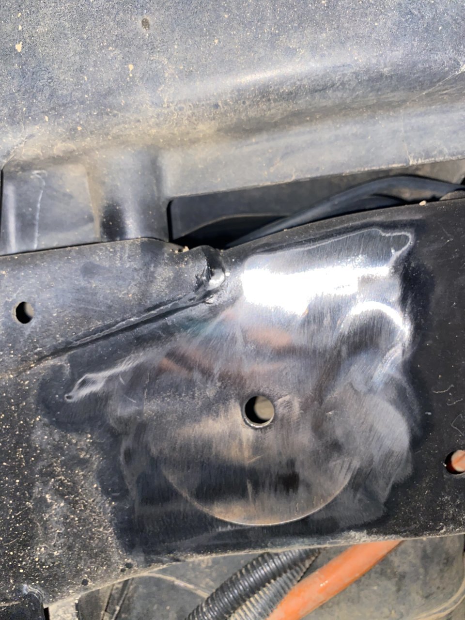

    Can anyone tell me if the frame needs to be notched here? Like on the 2.5 relocation?

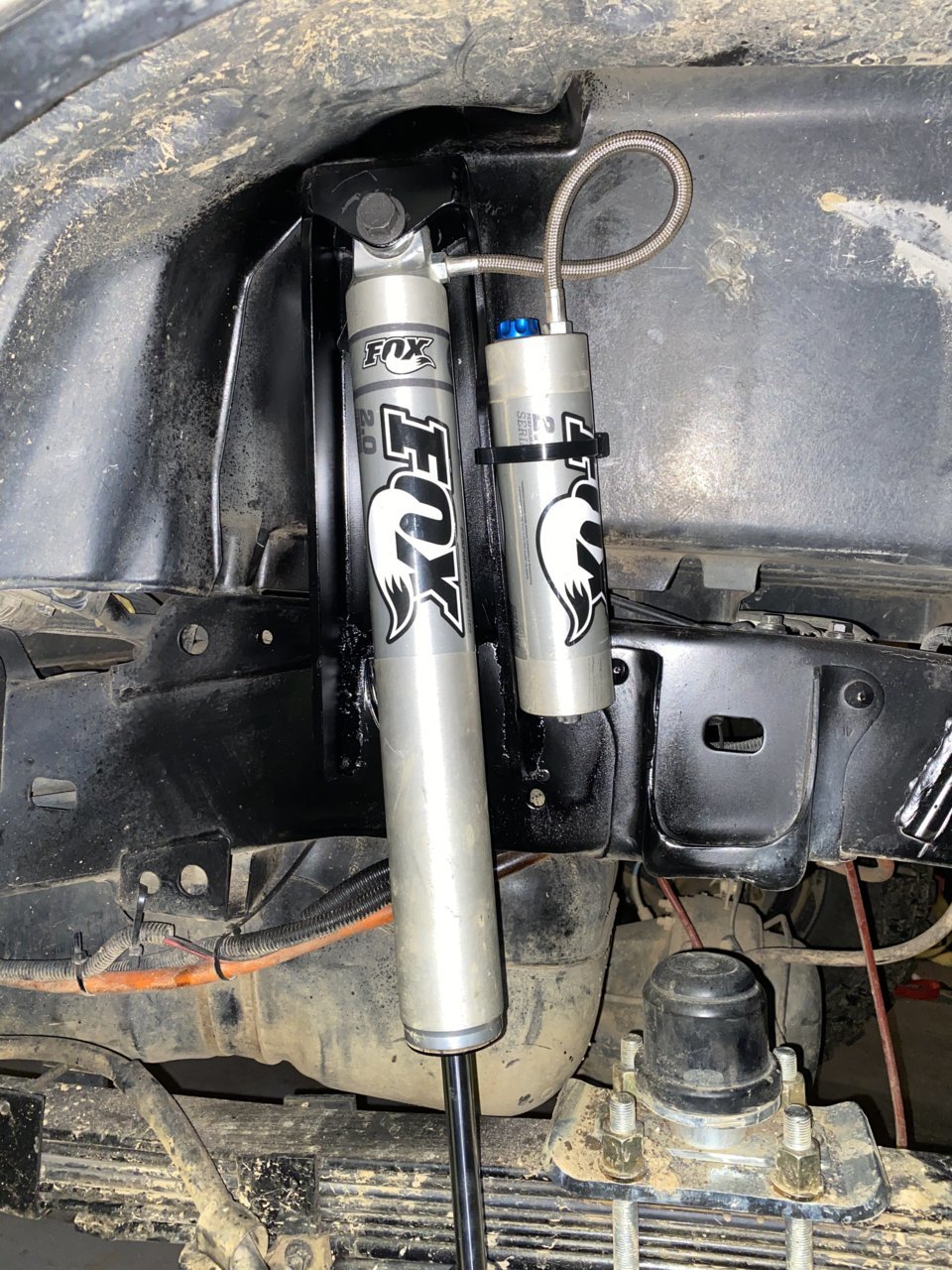

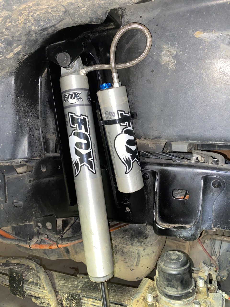

    Thanks @ARCHIVE for sending this out! I can say install was smooth. I did however already have the grunt work done since I was coming from another relocation. The nut tool worked great. I slid it up in between the inside shock mount and the bed. Used a flat tip screw driver to lime it up and stick the bolt in no problem! Welding wasn’t bad either. Ran beads down each face of inside and outside of the mounts. Can’t wait to get out and test further but my I tail thoughts and impressions are good!

    Thanks Brian, looks good!

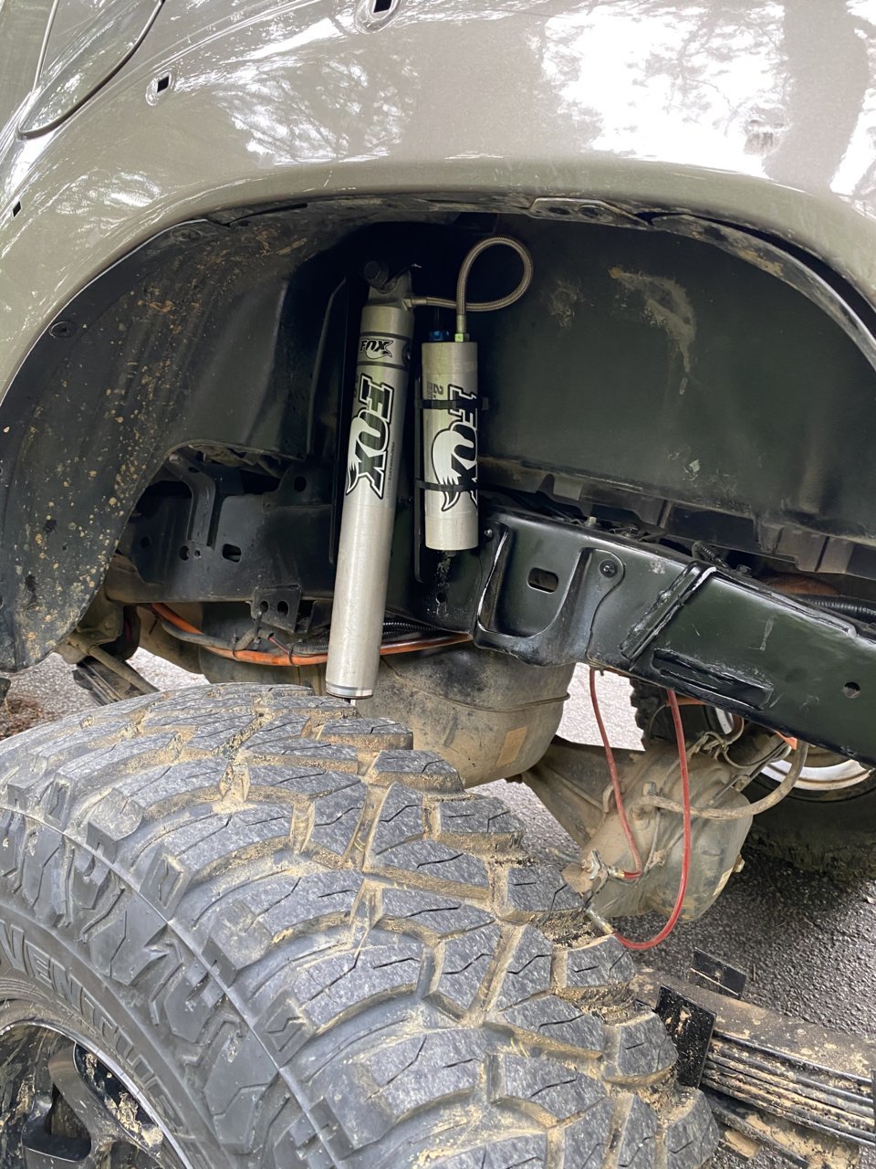

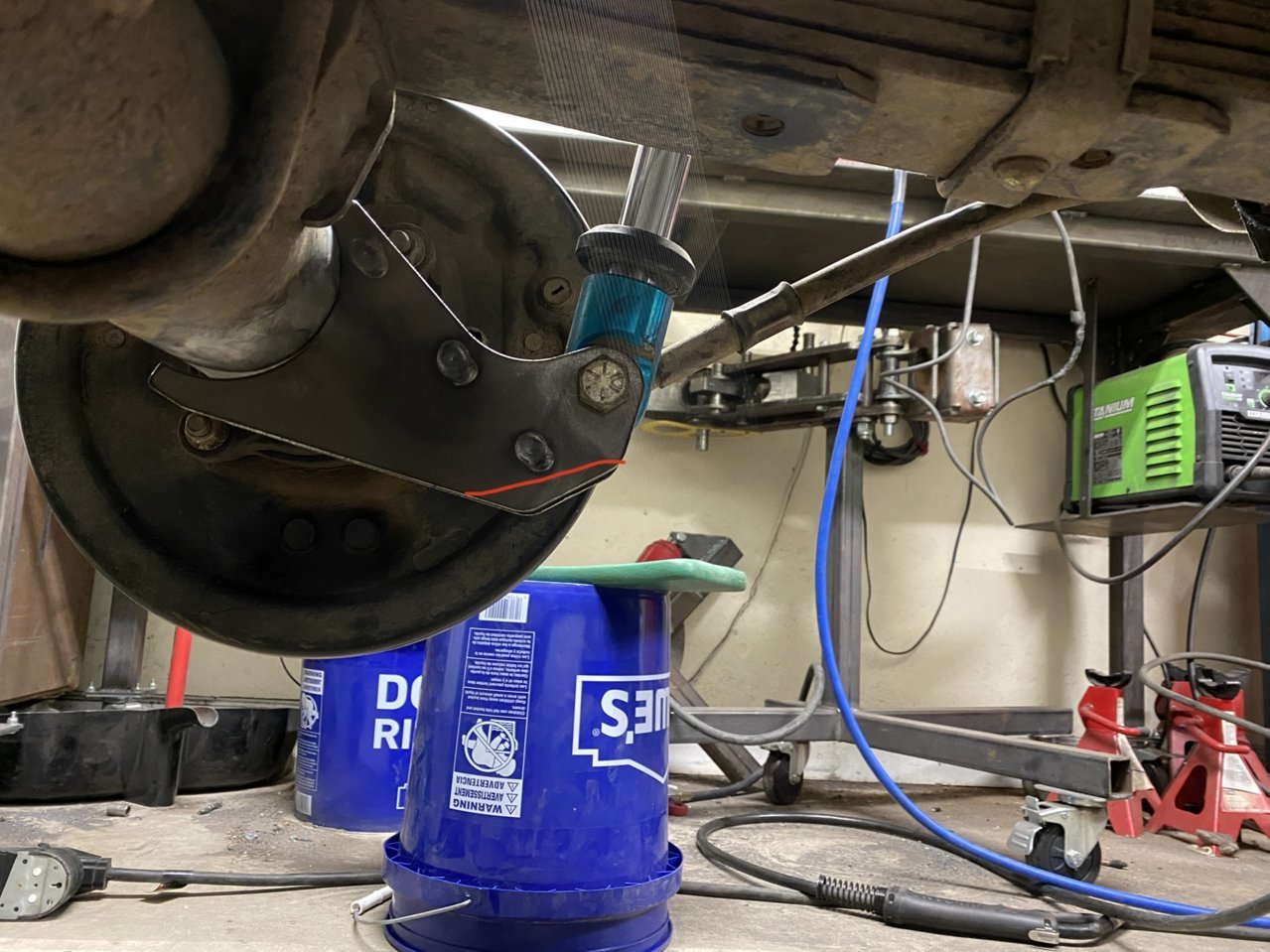

    @ARCHIVE , For the axle tabs, does the angle finder picture in the first post of the 2.5 relocation thread also apply for the new 2.0 relocation?

    Just measure your bumpstop bottom out to the strike pad distance and set your axle tab so the shaft showing is slightly longer than the bump distance.

    More or less in that range. I think the Fox 2.0x12 it might be higher than horizontal.
    Kinda need time to get a consensus

    For reference, here’s where mine ended up. They’ll all be a hair different but this is 2”x12” kings, icon rxt option 1, archive u bolt flip and archive bumps.
    Since taking this pic, I shaved off a little bit of the bottom of the mount for additional clearance.
