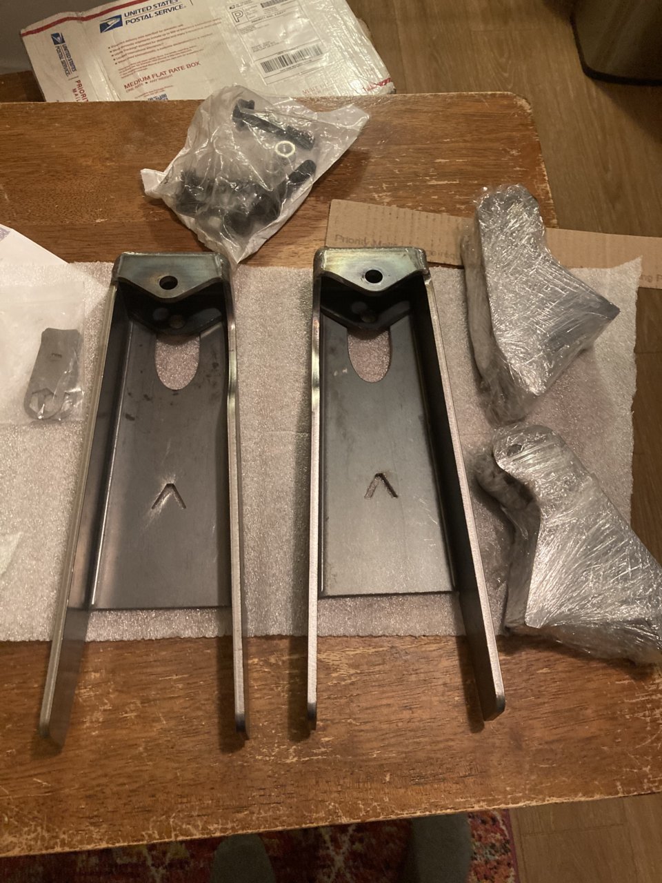

    They only sent you one??? Lol.
    That’s odd. I got both of mine in one large box.

    Yeah..... I'm hoping they shipped them separately. I called but it was afterhours. I'll find out tomorrow

    Mine came in separate boxes as well but delivered together....

    You might need to grind the weld flat on that part, but I think that was all one customer needed to do, then you can put the tower corner right under the corner of that bracket

    yes that’s all I did was ground the half of the mount that fit over the bracket flat and it worked out well!

    These bad boys showed up on Monday. Can’t wait to get the rest of the parts together so I can burn them in!

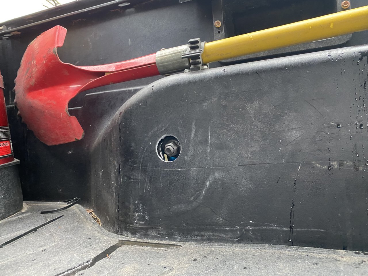

    Quick question. Any reason not to tack weld the nut on the back of the upper mount?

    you would probably have to remove the bed if that nut ever got damaged

    Yep exactly. If the nut gets damaged then you’re screwed. I just used a hole saw and cut a little hole in the bed to make my life easier. If I wanted to I could pop in a grommet to seal it off but didn’t see the point with an open bed.

    That’s smart.

    Why not just use the little flat wrench provided by Archive with the kit? As everyone else has said you'll have alot of work/hassle if you need to replace the nut.
