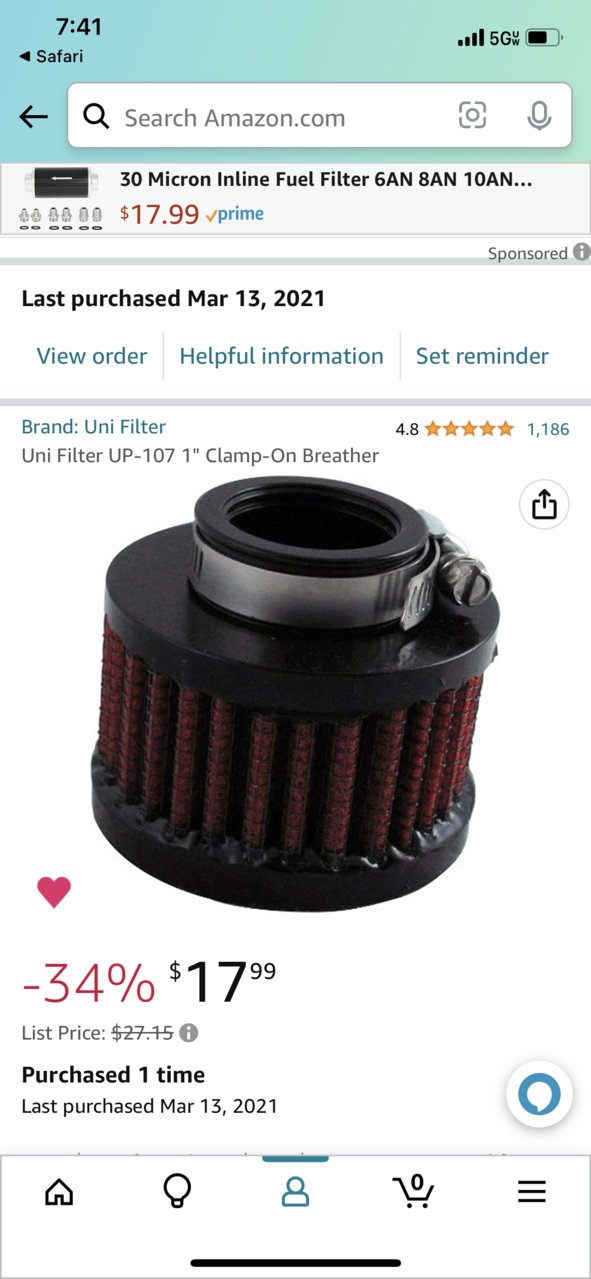

    Normal. Secondary air system. A bit loud on startup, stops after a few moments. 'Huffs' on shutdown.
    I also did the filter mod linked above by @nightcrawler . Doesn't change the sound, but makes less concern about imploding parts.
