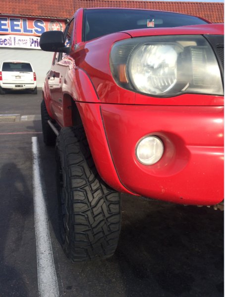

    I know this isn't the wheel or fitment you're after but I have 17x9 -12mm offset 4.5" BS + maxtrac spindles (my wheels stick out 8mm more than the SCS and 18mm more than Method)
    I can try to get a more straight on picture after work, this is the best I have right now.
    The maxtrac spindles will push your wheels out an additional .75"

    Hi ,
    What is the tire size of these Red Taco. looks nice. and I believe its the toyo tires. please advise your tire specs.
