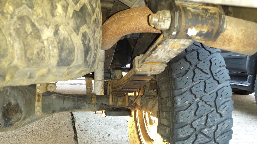

    Much better arch than before.

    7 leafs total. Top 3 are the factory Toyotas. Next down is out of a 90ish Ford 1 ton overload leaf pack, next 2nd shortest out of my 67 Mustang original pack, then another shorter leaf out of the ford truck, then the shortest leaf out of the mustang. Does that make sense?
    I had to do some trimming on one side of the leafs I used from the ford truck since the back of the leafs on my truck are longer than the front. Just eyeballed a length that looked good and cut.

    Only thing I have in it is my time. Got all the leafs for free so just working with what I got. :cool: I need to load my 4 wheeler in the bed and see how it handles a load one day. If it's not up to par I got access to a Ranger I might pull the overload leaf out of.
    Also noticed when doing my swap that I could really use some even longer rear shocks. Currently I have some cheap vatozone shocks on now so thinking I might upgrade to some 5150s or something. We'll see, budget is pretty slim at the moment so it'll be some time before I can get to that.

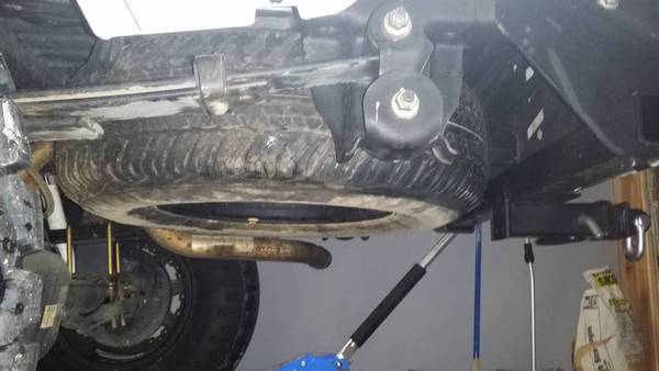

    Quick help. I'm at the junk yard and they have a ton of springs but the 10 I've tried they aren't coming out at all. Then I came across a 2000 ford ranger the leafs have great arch and are just laying in the bed will these work

    I'd say as long as they're 2 3/8" wide they're worth a try. Worst case you end up with a bastard pack like me.
