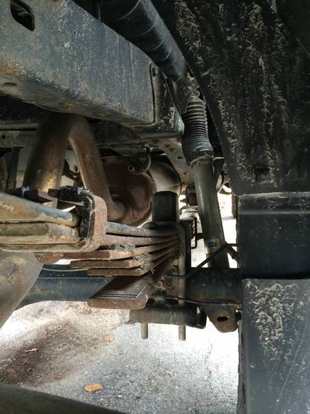

    Yours are in better condition than mine were.

    Easily, you still have ARC ,is that an AAL i see also ??

    ya has an AAL. not enough lift. so go get a spring from a junkyard off a old chevy?

    here & yes it is...

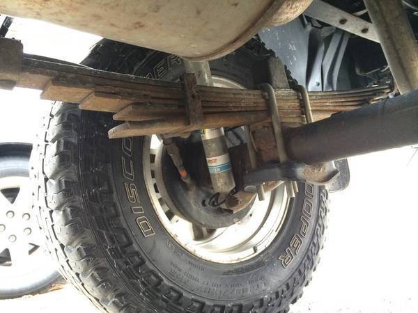

    Sorry Doug,
    The rain has been killer here. Just got some good shots

    That looks like a stout pack.

    It is. It just does not flex much. I am hoping removing the bottom leaf will add more flex or should I just remove the overload?

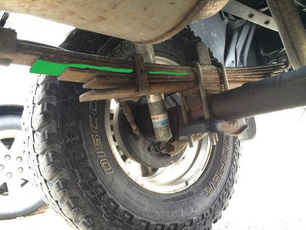

    Take out the 3rd leaf down & it'll help alot..

    I just want to be sure.
    this one correct?

    With your AAL you may only need 1 leaf , & it's personal choice but I'm no fan of the overload if not towing heavy & often

    Yes sir, thats the one...
    Doesn't have to be a flatbed, just about any early model Chevy truck will do..
