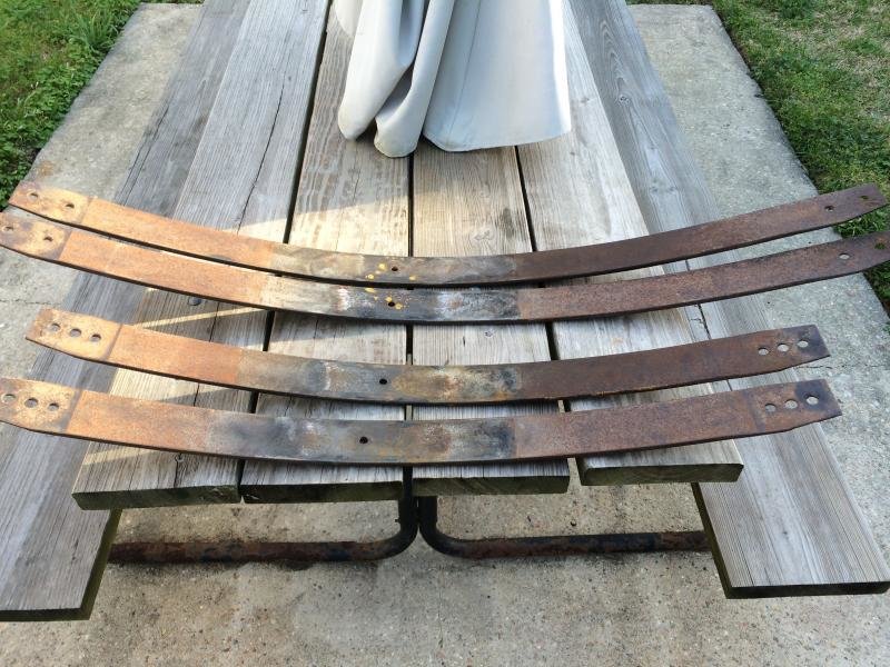

    Alright - I scored some 1996 Dakota springs and cleaned them up. I should have noticed, but of course I did not until I pulled them apart. They are offset. Does this present a problem for a 1st gen? The 1st gens are offset anyway right? Also should I be using the very top leaf out of the pack and cutting off the ends?

    Yeah 1st gens are eliptical or offset , shit just noticed , those are spring under, wrong Dakota, but i dont think it'll be an issue, those have pretty gentle ARC, I'd start with 1 spring (cut to match sequentially) make sure the short end goes towards the hanger end (front)

    Damn. I wondered about that. What year were you thinking of? I did not see any spring overs.
    At this point - I will give them a try and see what happens. What do you mean cut to match sequentially - you mean start with the shorter? I am just cutting off 3.75" from each side right?

    It needs to be ground just enough to allow the Ubolts to flip over without bowing out or being difficult to push down over the bumpstop area/centerpin If its a true 2.5" wide I'd spend the extra few minutes going down each side of donors a couple times with grinder more for uniformity than anything else..
    I'm sorry dude I can't rememeber which years that covers , theres a sheet that Randy just put up (reps coming your way for that Randy) that has a list of vehicles w/spring specs. check it out...

    Yes, make each cut 3.75" off each end of donors used, this will make them sequential
