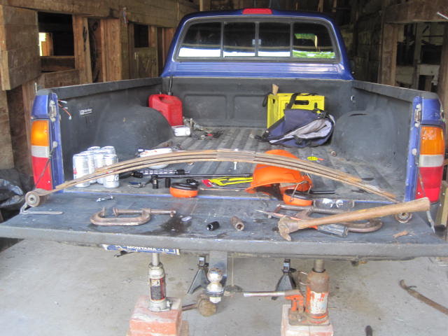

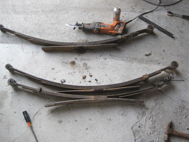

    I spoke with you about a year ago concerning my sorry ass leafs, and ending up reading the whole tread. I didn't have money at the time to do it, but kept it in mind… until i did my clutch on monday and crawled under there to see two broken leafs on one side and one broken on the other!!!!
    So I went junk yard shopping and came up with a beautiful set from a 2005 ford sportage i think. They had a little more arch and are thicker (same width) as the taco's helpers. Ended up un bolting all of the leafs, mocked em up and they were close enough (within an inch) of the original taco helper leafs lengths. So without any cutting or drilling, I bolted em all together and frigging love it!!!!! Best mod I have ever done. I can now take dirt roads 10-20 mph faster without bottoming out as I did before. I should have measured before and after, but I think I got 3" of lift after settling for three days. I am lifted 2" up front and I have an inch rake right now. Thanks again for all the info, I will post some pics in the am if you're interested!
    -Tom and the Purple TACO.

    Always happy to hear great results Tom & hell ya, put up some pics !! I always tell peeps to after they do the mod but few do...
    Anyway nice job & looking forward to pics....:thumbsup::thumbsup:

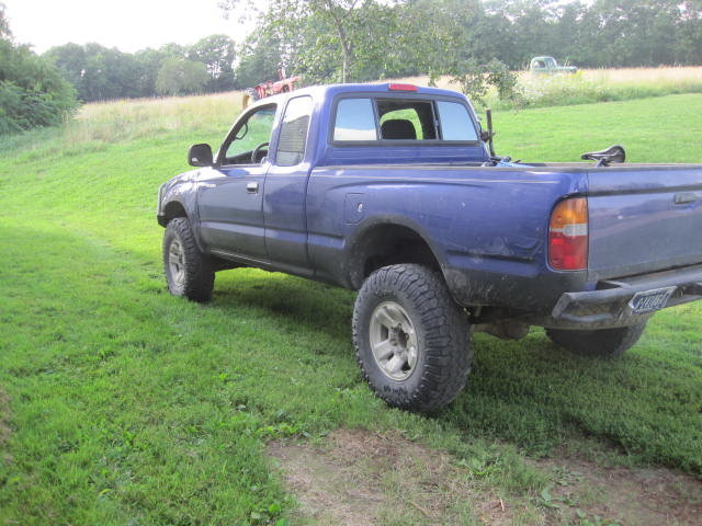

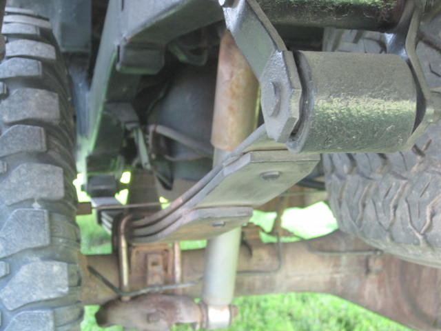

    Here you go: old leafs on the bottom of the first photo, donors just above em. Then installed for the last two photos. Hopefully they settle a little more. But I wanted an 1" rake as I have a topper with luggage rack and shit ton o' gear.
    Thanks again!
    -Tom

    Thats really nice ARC Tom, def. looks like a 3" gain....
