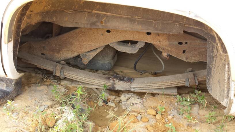

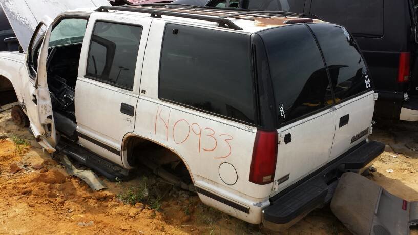

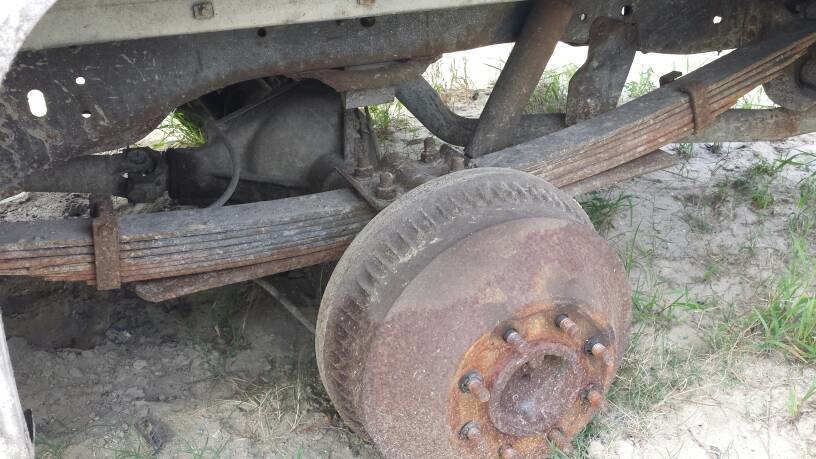

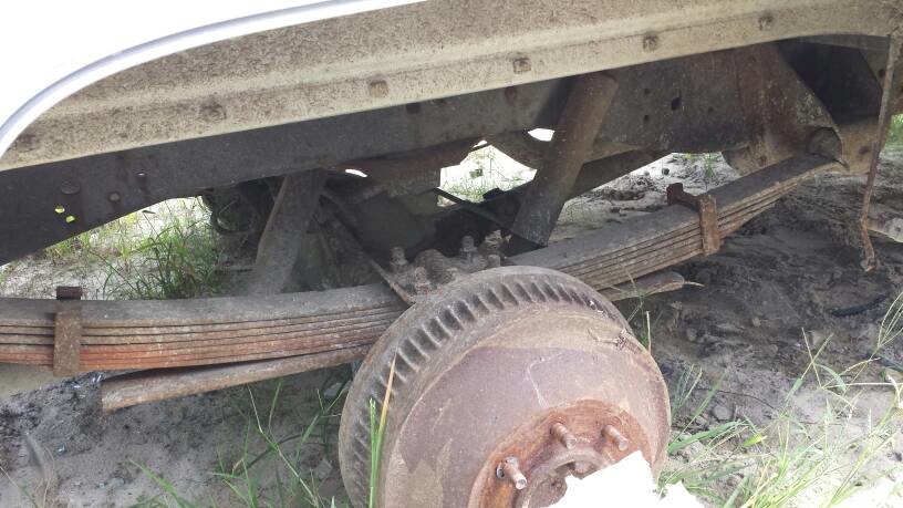

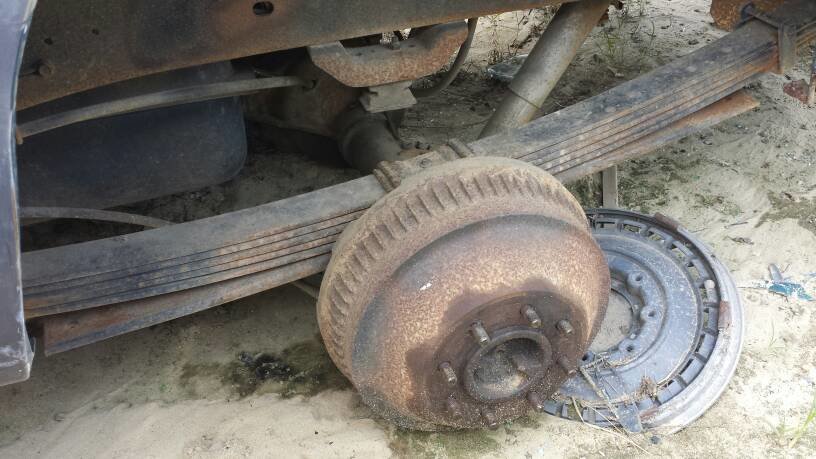

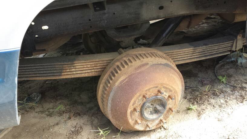

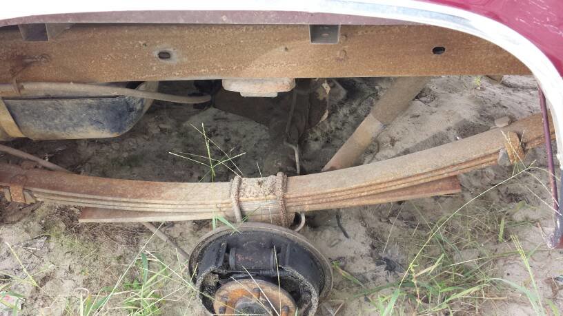

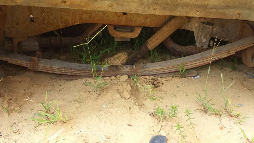

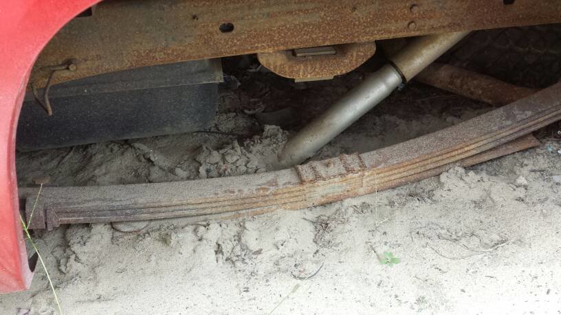

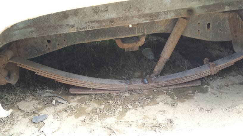

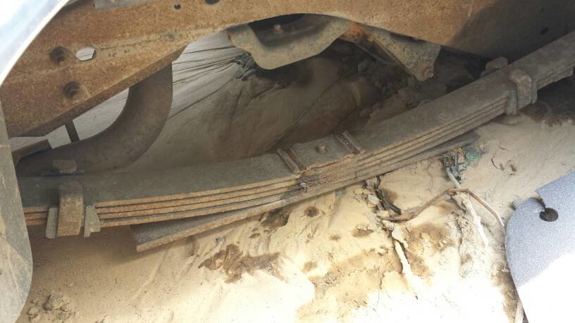

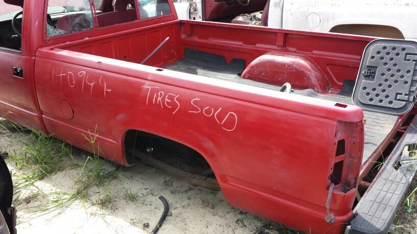

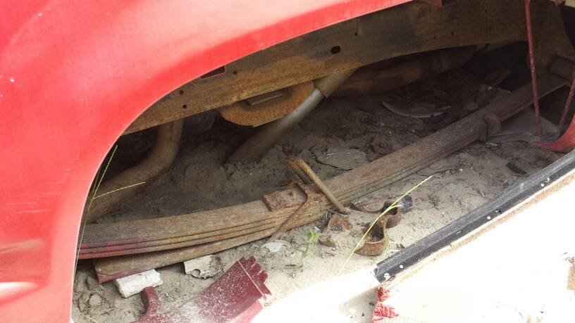

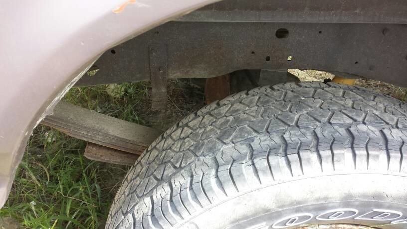

    Just went to a junkyard. Here are the prospects. Didn't have time to pull anything.
    1.
    2.
    3.
    4.
    5.
    6.
    7.

    Nice.....I see some really nice builds coming from those....:thumbsup::thumbsup:

    Which set from your experience looks the best

    This one for uniformity......
    This one has a nice even ARC for lifting...
    They're all pretty decent springs from what I can see.....

    You drove all the way out there and didn't get any? What a bummer. Looks to me if all you are looking for is a single leaf, you can get enough out of that big arc for both trucks.

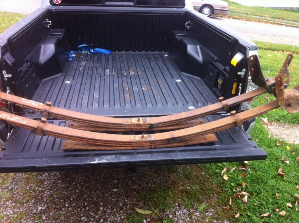

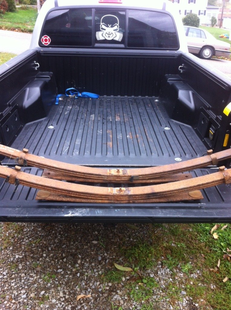

    what an epic thread! thank you to Doug and everyone else who contributed to this! i read every post, and thought i had a pretty good handle on what i need to do to complete this mod. i managed to find a donor set today. i'm a little bummed though because i must not have measured very carefully when i was at the JY. i swear they were 2 3/8" wide in the yard but damn if they aren't 2 1/2" wide now that i'm home. i have a '13 and it seems like this is not a deal breaker, just some extra work to make a clean install. here's a pic of the donor packs from a '90 chevy 1500 4x4:
    they seem like they have a pretty even arc to them. i have the 3 leaf plus overload from factory. it's never had any load in the bed and only 22k miles on the truck. my plan was to install the eibach springs up front with 5100's set at .85 which should yield just under 2.5" of lift and i'd like as close to level as possible in the rear. so i'm shooting for about an inch to 1.5" of lift in the rear.
    i just want to clarify, i should be good with one chevy leaf under my OEM leafs and remove the overload to achieve this?
    do i use the "flip the pack over and measure to center pin" method described a few pages back by assembling my new pack and shoot for a measurement that is 1-1.5" taller than my stock measurement?
    i guess i'm hoping to just disassemble and reassemble once. is that even possible?
    thanks again Doug, you are the man!

    Thanks Josh, I appreciate the comments.... & I agree, under that surface rust you have some nice donor springs, good even ARC...
    This is a great way to find out where you are as far as height numbers go, & yes, you may find that just 1 spring per side will put you exactly where you want to be, as far as the overload goes, like I've said in earlier post, I generally dump it, only time I'd have one is if I towed heavy & often, shit, I have a completed,ready to bolt on set of OMD springs for a 2nd gen that give exactly 1.5" of lift....
