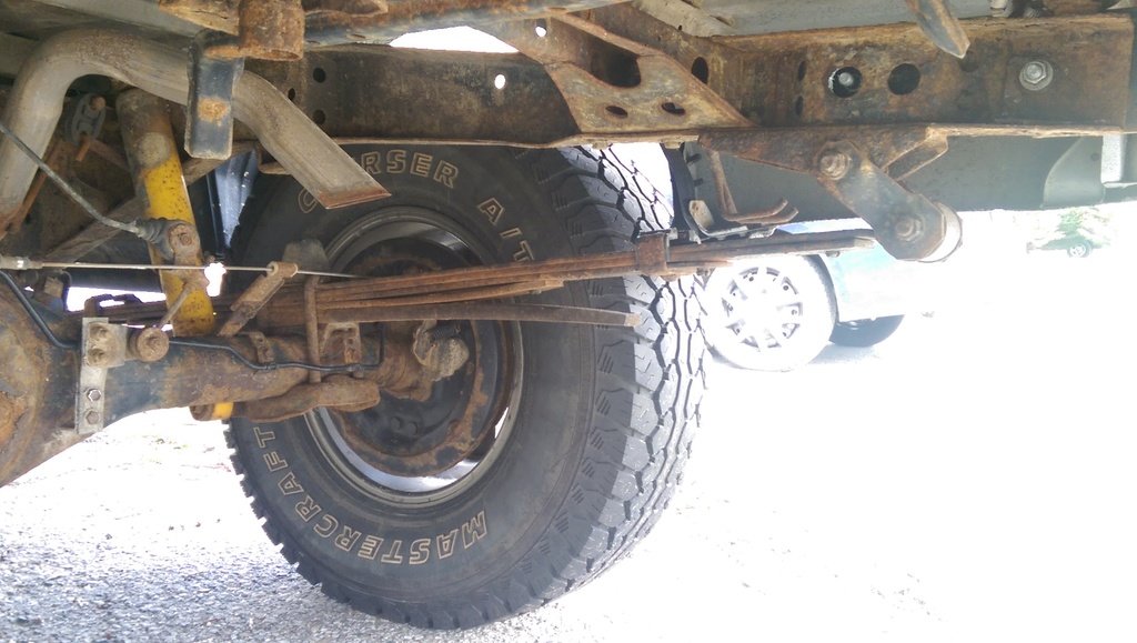

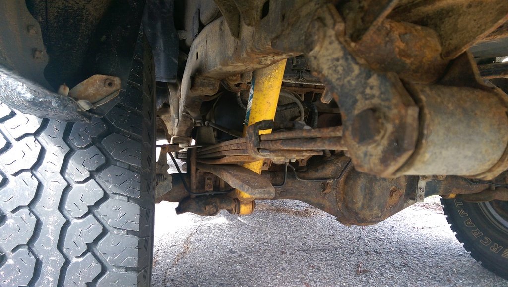

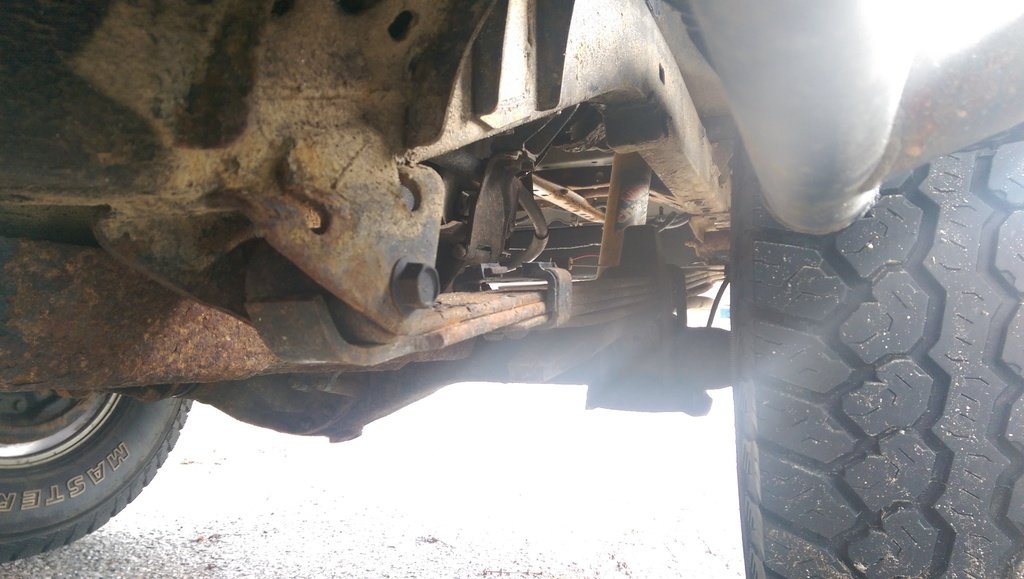

    You'd never know it , but yeah still sucking air haha:)
    As you can see , the single AAL is bearing the brunt of the load, no uniformity or support uniformity for the other leafs, you need to rebuild , they'll come back if done properly

    So you think the main leaf is worth saving? If so I'm thinking to keep the main one and the AAL and swap in two beefier ones closer to the length of the main one than the AAL.
    Any opinions/suggestions from anyone are appreciated.

    Pull all the leafs you have now, add 3 or so leafs from Chevy, and drop the AAL.
    Most of the people doing the mod have had the greatest success using the main (toyota), and all Chevy for the remainder. The lift being adjusted by the arc of the new spring(s),and the load capacity by the number of springs installed.
    I would try to redo yours completely.

    That whole pack really should be tossed, and replaced IMHO. The aal is doing all the work.

    Ouch, Yea I would agree. *do the wave*
