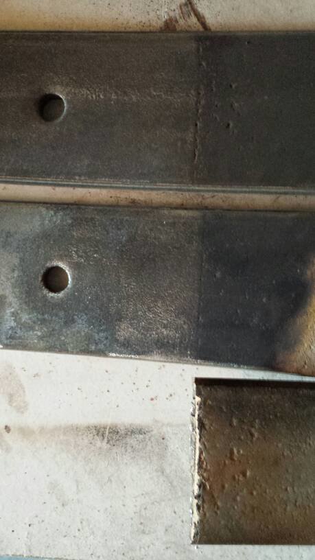

    I DO see considerable pitting, but it isn't the number of pits that concern me, it's the depth of a few that does, this is why I "scale" my potential donors with the edge of my grinder removing a small amount of material around the suspect area , a slight wear mark from anti squeak pads is generally just that & not a fracture of impending doom.....

    Thanks Doug, we'll grind it down before painting. It was just a concern because I think that's what caused the one to break. Wondered if we should hit the JY or not.
