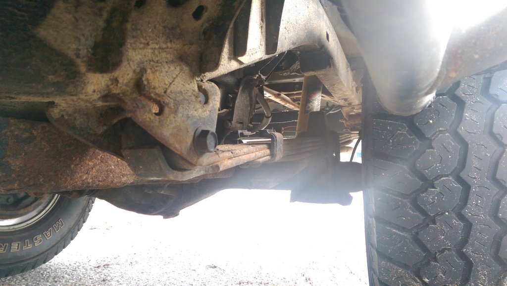

    Hey guys I have a question about a 1st gen spring rebuild I did about three years ago using OMD methodology.
    I used two 94 chevy 2500 leaves as donors and kept my main toyota spring as well as the one just below it with the curled up tip at the front. Fast forward three years and the rebuilt pack is still holding an arch quite well, with a bit of sag in the front of the toyota leafs where they extend past the chevy ones.
    My question is: if I remove the lower toyota leaf and replace with a chevy leaf of the same length, will I have to bend the tip of it around the eyelet of the above toyota leaf? Is there a safety function of this bent tip? The resulting leaf combination would be from top to bottom: Toyota, Chevy, Chevy, Chevy. Or is it preferable to maintain two toyota leafs on 1st gen packs? Thoughts?
    I realize this was likely mentioned earlier in this thread but 146 pages is a lot to sort through. (This picture isn't of my truck BTW)
    Thanks!
