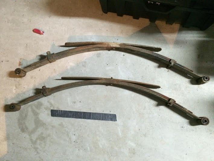

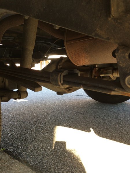

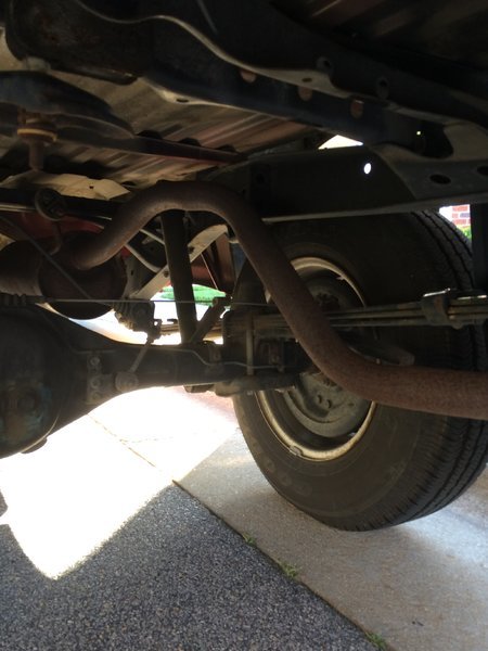

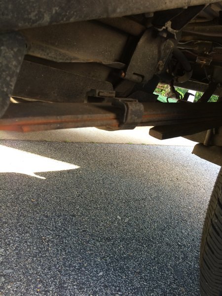

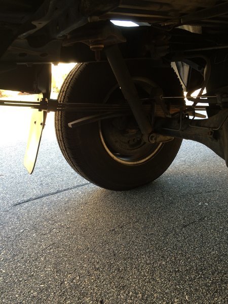

    I'm looking for some insight on people that have done this mod on their 1st Gen. Right now, I'm set up with stock everything. I've pulled a set of springs off of a Chevy S-10. I will be installing Bilstein 5100s all around and will set the front at the 2.5 (max) setting. If it is possible, can someone glance at my current springs and recommend what I should take from the Chevy springs to give me the 3 inches I'll need to look level. Thanks in advance.
    Current springs:
    New leafs:

    Hey, I haven't done this mod yet and don't have a first gen, but I might be able to help you and will at the least bump the thread.
    So off topic of your question, you have a 2.7L 4x4 and you want to set the front to 2.5 on the bilsteins? This sounds like a bad idea being you have the 4cyl which I assume weighs less than the 3.4L v6, which the lift numbers are based on. You may end up adding way too much lift up front and putting excessive wear on your cv axles and also causing a bad alignment which leads to bad tire wear. You may want to research some more about lifts for 2.7L 4cyl 4x4s and I would recommend you buy new coils and set the bilstein to zero, letting the coils give you lift instead of a preloaded OEM coil.
    To your rear lift situation, try to read some of this thread and maybe the first page (not sure where good info is for ya). If you keep only the top most main Toyota leaf(the one with the bushings/eyelets) then I would add 2 of the chevy leafs under that and see where you end up. Getting your desired lift height isn't going to be an exact science unfortunately.

    Thanks for the info. I have read about half of this entire thread. Due to Doug's situation he's often hit-or-miss with info which I was getting from PMs. I will look further into other lifts for the 2.7 and see if I can figure out what will work.
