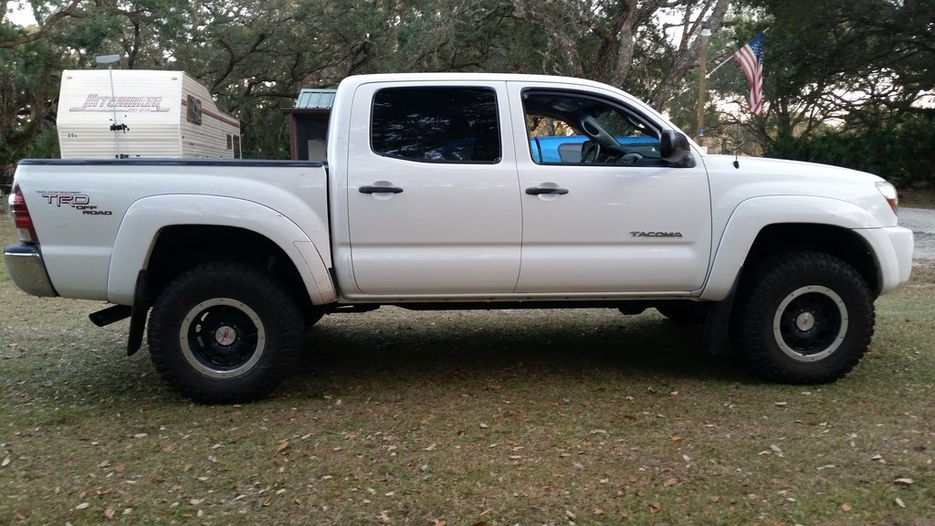

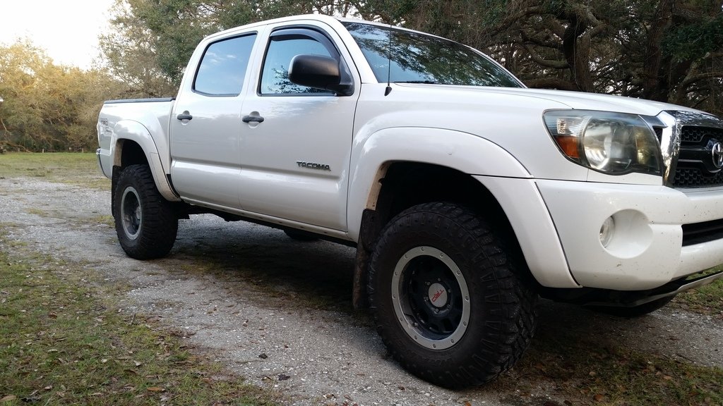

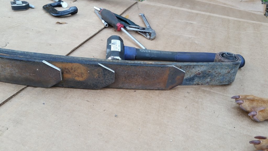

    Got the version 2.0 springs installed today. I went ahead and dog eared the ends. Same exact ride height as the first set but feels plusher.
    Went with: Toy main leaf> Ford 46"> Ford 34"> Ford 26" . Center hub to fender is 24"

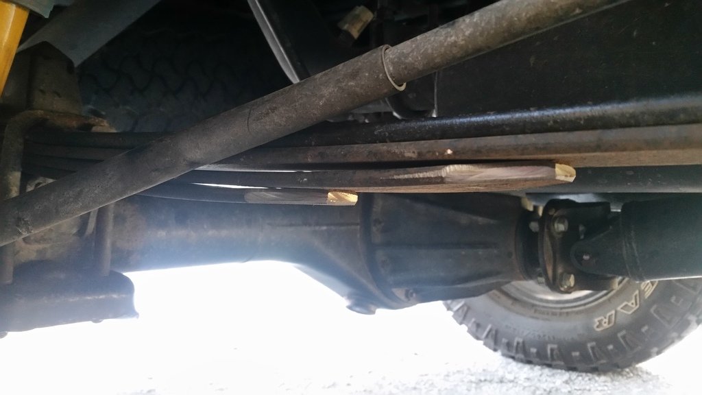

    Yes there are still gaps although not a large. I am not too worried though. When I take it apart again to paint I will add friction pads and tapper the ends a little to relieve stress. I looked at my work truck (2010 F-150) and there are gaps in it's springs also.

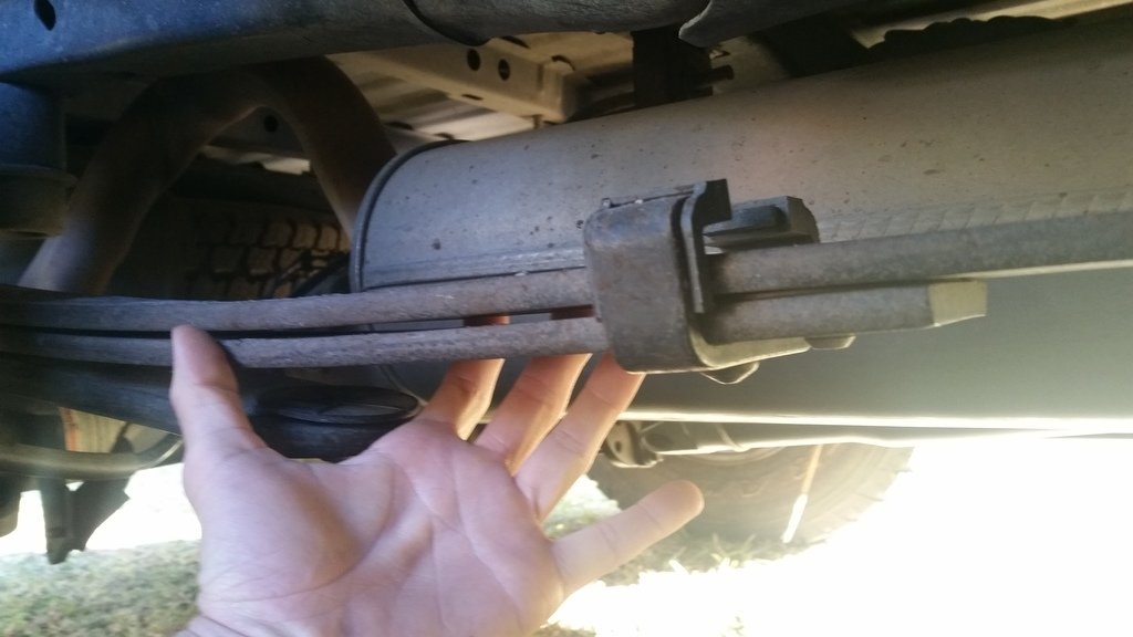

    May need new leafs.. Any thoughts on what happened here? That's a set of Toyota 3+1 (new frame springs) with the 3rd leaf swapped for a Chevy leaf and the wheelers 3 leaf aal. Don't mind the brake job.

    Looks like a high stress point where the front main leaf of your AAL contacts the Chevy leaf. maybe when your springs went negative during compression caused it to bend. I believe that is why you don't want more than 4 inches between leaf ends. I would get rid of the AAL and add two Chevy leafs. Keep the factory overload if you tow heavy often.
    Looking at the picture again I can't tell if they are permanently bent or that way because you are flexing them up. Can you provide a picture of them resting level?

    If I'm seeing that right, it's bent right where the end of your overload is. What were you hauling?
    Or how high did you jump?
