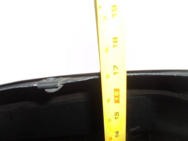

    Yep, its official... I actually remembered to do a measurement BEFORE
    a leaf build (rebuilding my own this time)
    Tonight just a measurement, tomorrow I'll do a condensed step by step w/pics & vids (maybe I'll catch myself on fire again but this time caught on cam)...:eek::D
    Ok, this first measurement is from the middle, on top of rear brake drum up to bottom edge/middle of rear wheel well... looks like a before shot of 17"
