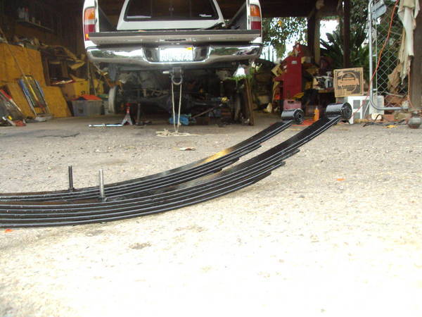

    Ok these are going on right........

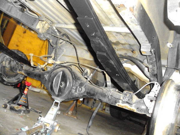

    NOW .......
    Glad you got a rotor Reagan.....
    Hi Sean, thats what I'm doing now with just the main spring..

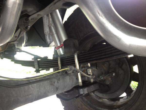

    Add me to the list doug as well as trd7 I rebuilt his a long time ago and just got around to doing mine!
    & holy crap, let me tell you, they ride soooo good compared to that shitty "aal" i had before with the same amount of lift... sittin at 39 1/2 in the rear and 38 1/4 in the front so just over an inch rear rake!
    Ended up with a 5 leaf pack, 3 of my stock ones and 2 off a 2ooo dakota, similar in thickness maybe only 1/16 difference so they matched about perfectly, and some new center pics and i was golden! Now just gotta go in when the bumper is finished and add in a new cross member for shock mounts /\

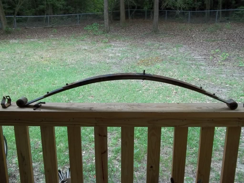

    The donors:
