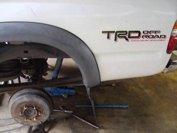

    heres a pic of what i was looking for... if the main is actually "bent" in between the 2 blue marks (roughly first 10" from either eyelett) its basically scrap & I don't bother with it. Sags & droops are one thing, bends & breaks are quite another...

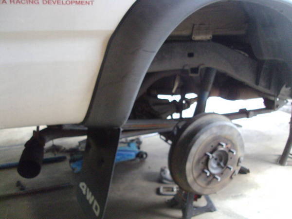

    I need some retainers too. My passenger side is pretty bad I noticed but I haven't been that urgent about it. Ill have to fab some up sometime.

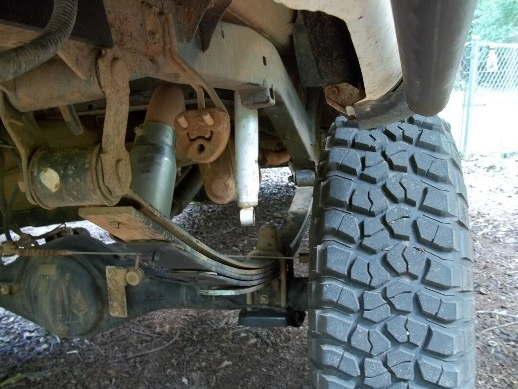

    Damn dude , you got some nice ARC out of those....:thumbsup::thumbsup:
    You'll get mad flex out of those....
    Can't get anymore droop than this..

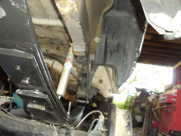

    I built these yesterday & installed last night....
