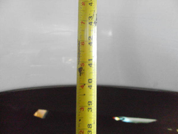

    Take those same 1-2" of nice compression & start throwing some American steel behind the main for some real spring rate & back them up with an upgraded shock & the proof is in the puddin', results don't lie...;):)

    Truck, on wheels, level ground, measurement taken from floor to bottom/center rear wheel well.....right at 40"...

    Look at build!
    Dang, mine is at 39 1/2 at the bottom of the fender flare, and i want to add 1 more leaf :eek:

    You're prolly a little higher than me, my flares are off when i measured...;)
