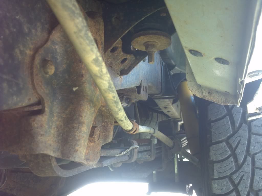

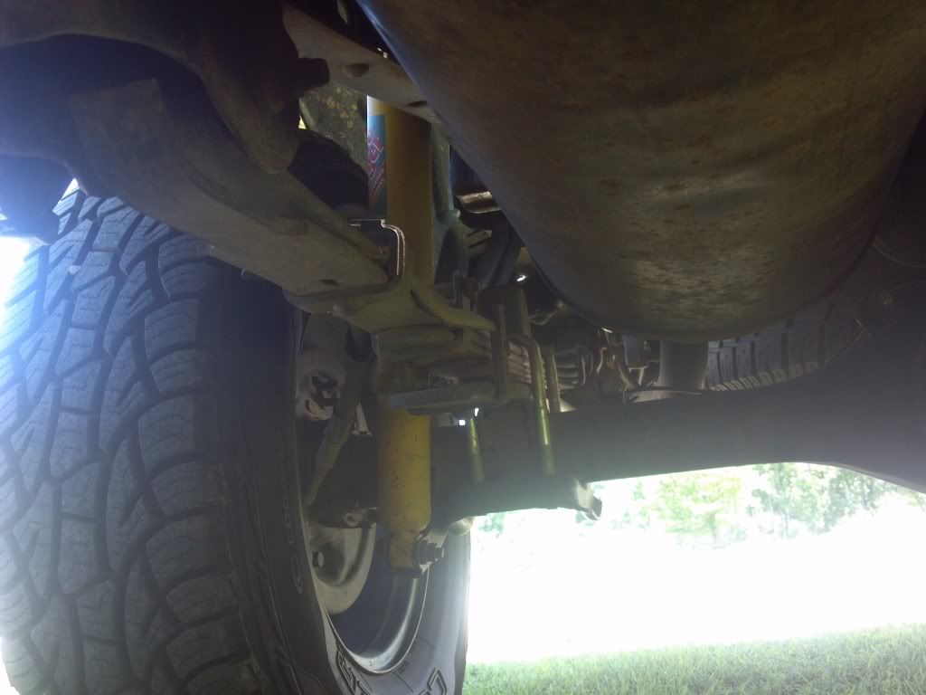

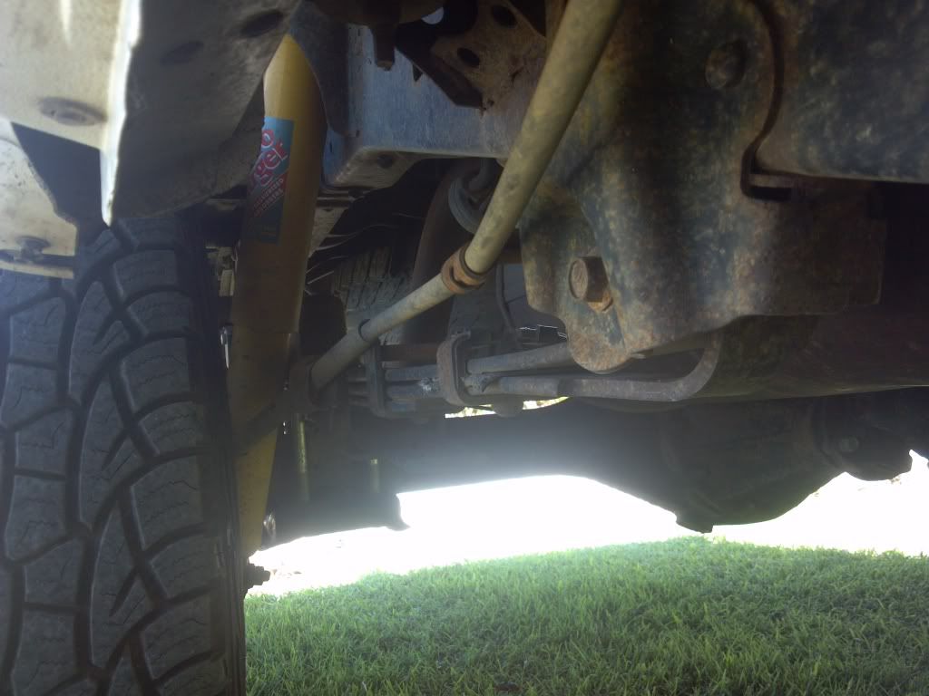

    Doug here are those pictures you asked for. Am I still looking at one Chevy each side? Should I replace the Second Leaf like I'm thinking or should I add the Chevy to what I got
    http://i249.photobucket.com/albums/...ma/Mod Podge/CameraZOOM-20120528131051687.jpg
    http://i249.photobucket.com/albums/...ma/Mod Podge/CameraZOOM-20120528131124862.jpg
    http://i249.photobucket.com/albums/...ma/Mod Podge/CameraZOOM-20120528140209416.jpg
    http://i249.photobucket.com/albums/...ma/Mod Podge/CameraZOOM-20120528140238942.jpg
    I just put the links so people can find the Info and not look at my springs. Will post before and after shots later.
