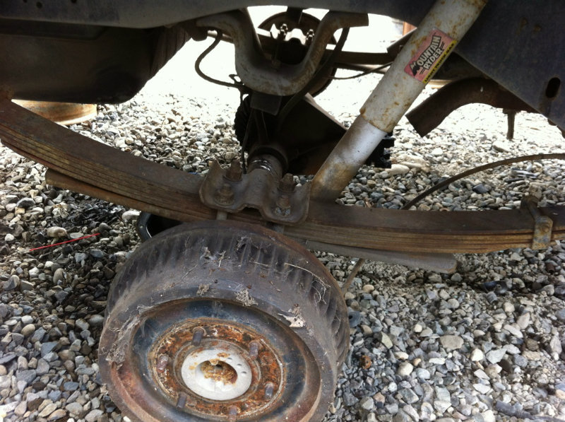

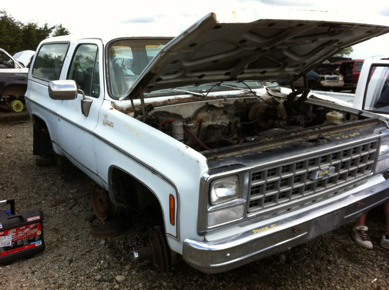

    At the yard now. Hoping this is what I want

    Never mind too wide. Still hunting

    Back home in defeat. Looked through about 30 trucks, everything is 2.5 - 3" wide. Toyota made these 2 3/8" just to piss me off, I swear.

    Mike, if you just cleaned the rust & scale off of them with a wire wheel on a drill I bet they'd fit, those springs had a nice ARC (almost look like after market springs, check bushing) Trust me 2.5" isn't a deal breaker, break down & clean/inspect donor leafs like you would anyway, measure/cut/ place donor springs where you planned, center pin ,tighten & set into place on axle perch, now loop your U bolts over the pack rest them on bump stop, get a sharpie & mark where they line up. Now take your angle grinder & make a couple passes over the marks, beveling them slightly on each side of spring, you have now given them a saddle to rest in.... Re assemble ....;)

    Thanks for the response doug - Ill go try nabbing them tomorrow then. The u bolts might suck to get off, I don't have a socket that big (over 3/4"). Going to try with my big monkey wrenches or it's time for a harbor freight run (oh darn, right? :))

    Yeah it sucks to buy tools ....:p:p
    I was going to ask if you could find some with a little more rust till I saw where your at....:eek::eek:
    The best tool going out there for retrieving springs is a cordless angle grinder with a few batteries & blades & a cordless sawzall with good blades...
