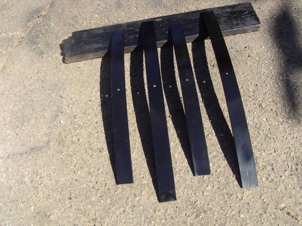

    These are going to NorCal to member Strohski (Chris) in a day or 2.....:)
