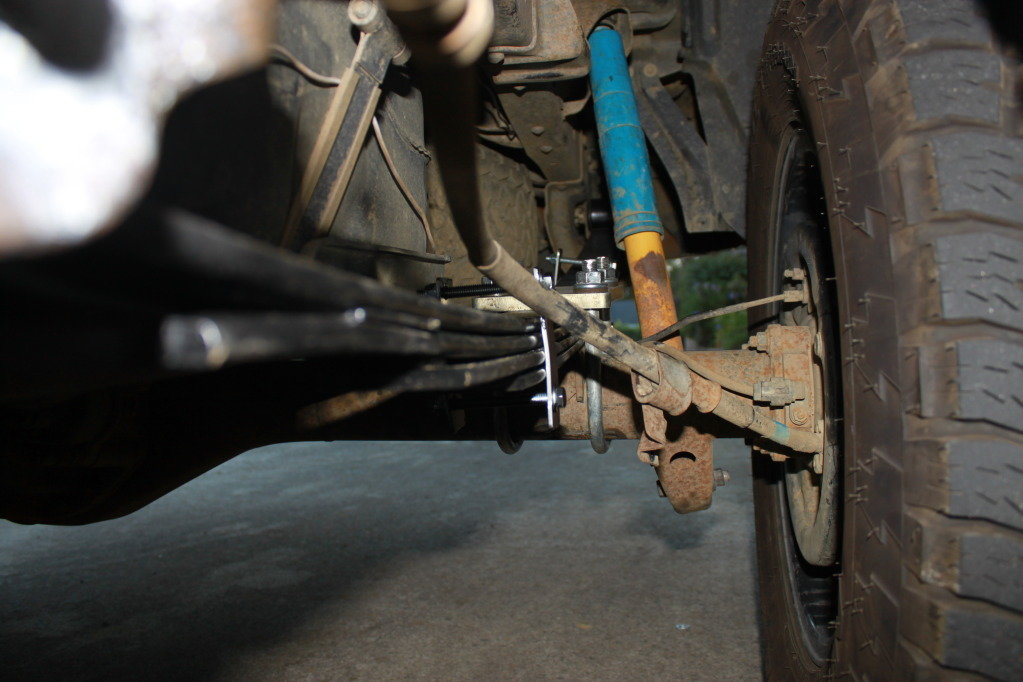

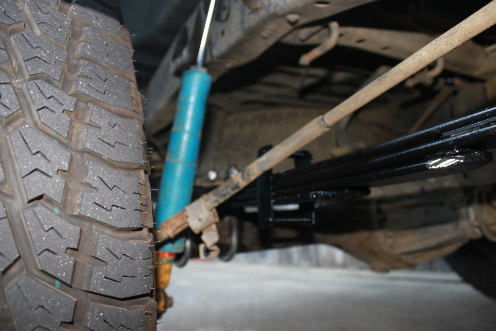

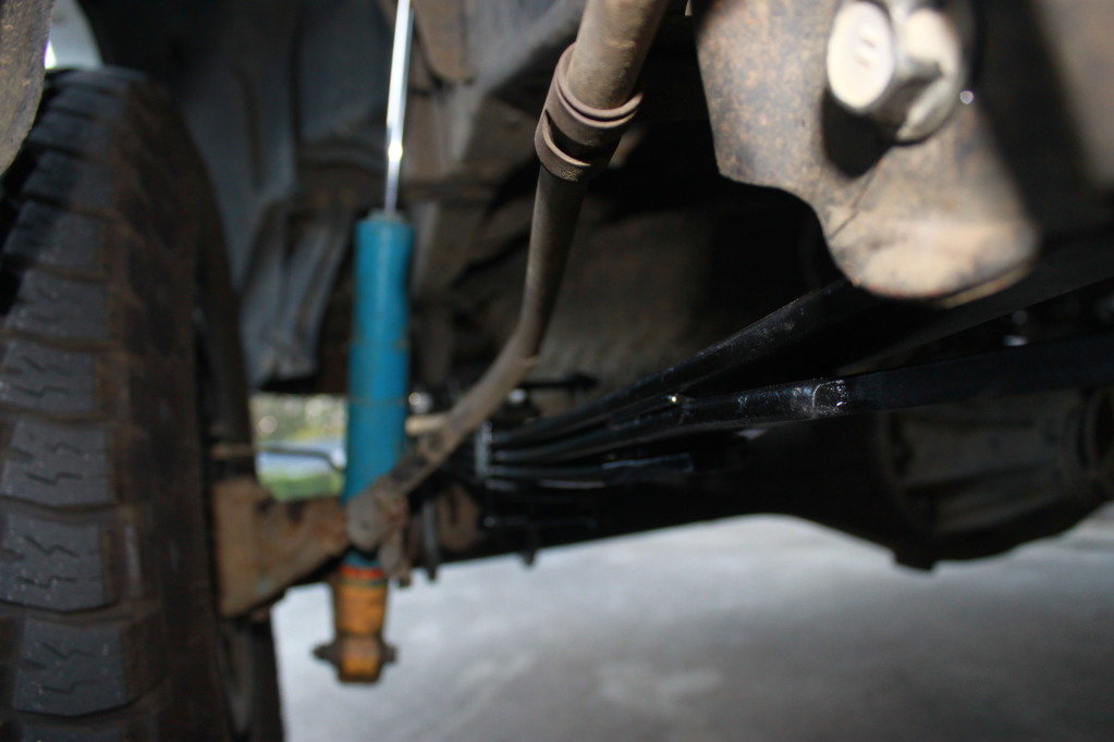

    Got my OMD leaf pack installed a while back. No squeaks! can't fully test until i pick up some rear extended shocks
    Click for full-size image (1023 x 682)

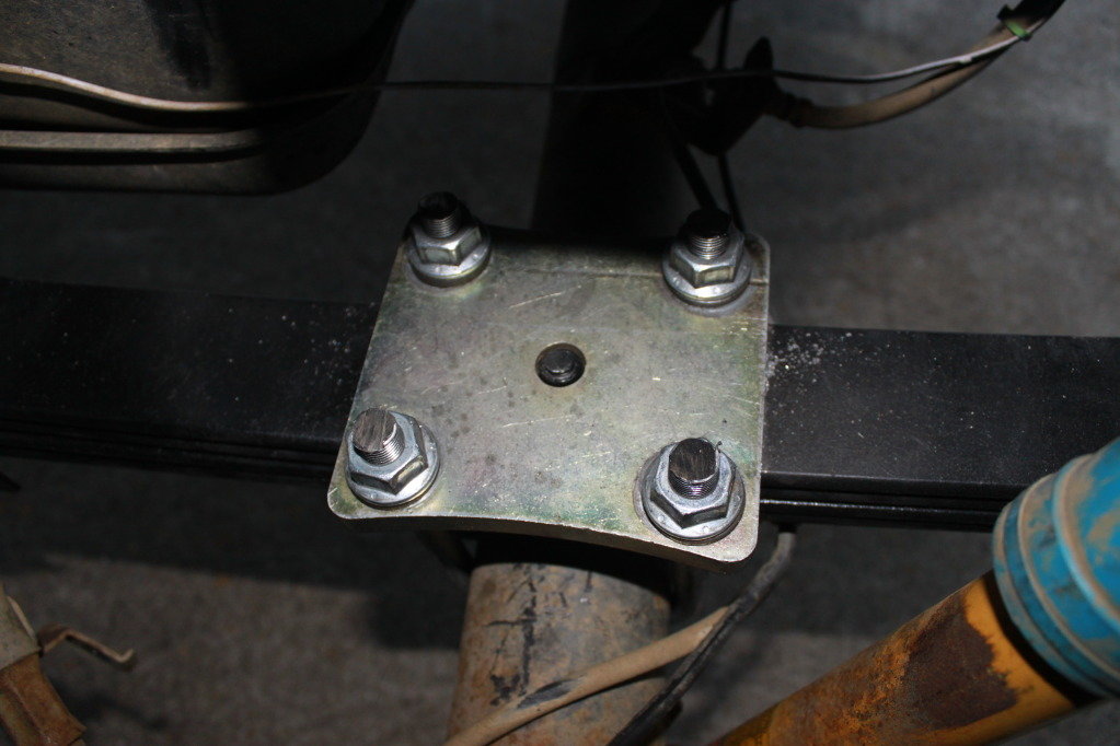

    Also got the All Pro U-Bolt Flip kit on
    IMG_5935_cb0895bce030e89a1ab39ecd0cf3409dfc924050.jpgClick for full-size image (1023 x 682)

    Looking good chris... one suggestion for the clamp for the emergency brake cable, you can drive a self tapping screw into a spring clamp to hold up out of the way....:cool:
  8. Aug 30, 2012 at 1:48 AM
    #748
    CayucosTacoma
    CayucosTacoma Just think outside the Yota
    Mar 9, 2012
    #74580
    5,597
    San Luis Obispo/San Jose
    2004 Double Cab 4x4
    Specs in the Build Thread
    Yeah was actually going to mount it to the clamps screws, but i was super tired after install. Install took a while longer than i thought.
