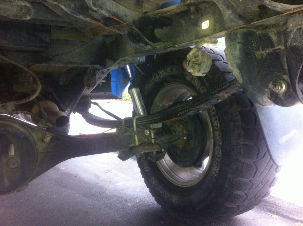

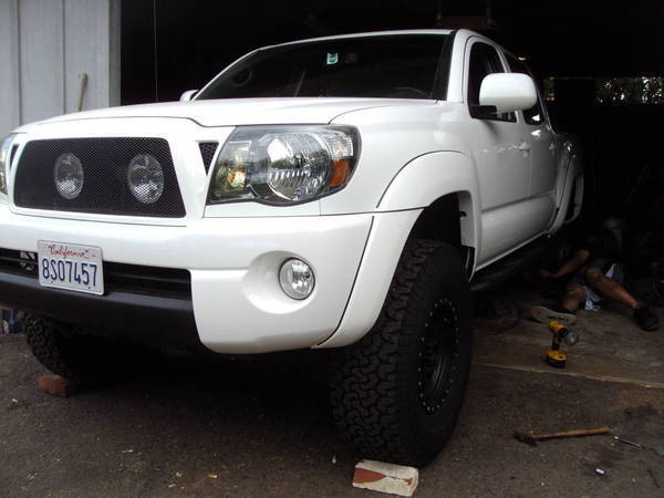

    Just want to add an update on my springs:
    Doug and I worked on and threw in a 4 pack of Ford leafs into my truck right after I got my LT done; perfect timing due to the Mojavi run being soon after.
    Well 1 Mojavi run, and countless desert trips, runs, high-speed trail-blazes, campouts and jumps- alone and with the group- to the desert have yielded AMAZING results with these springs. After experiencing OMD springs, I can not recommend any spring manufacturer for a standard over axle spring other than Doug's. This is how the springs sit as of this morning after thousands of miles of use and abuse.

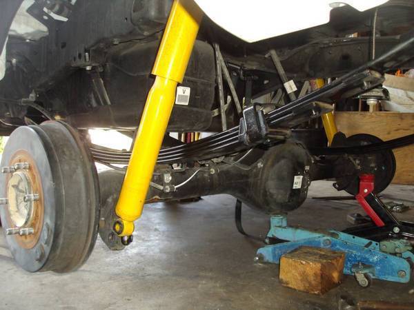

    2nd. gen. Main, 3 Chevy = 3" lift

    Pretty tight spring w/drop in squeaks....

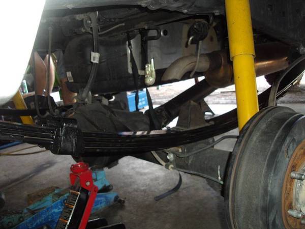

    Ok, another notch in the OMD FTW section......DP4x4...enjoy...:D
